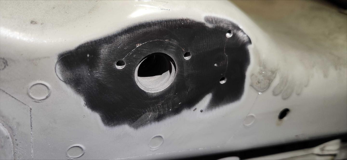

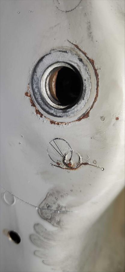

                  maybe the last, and biggest project in the way of getting the car back into regular usage is almost done.
                  got an email from the shop (Chicane, who some will know as Brad Perkins from the old forum) that the RACP reinforcement might be done by the end of the day. post mortem is the car was in good shape, with only two minor cracks forming.
                  solid subframe bushings, ball joints, and OE RTAB with limiters going in at the same time. diff bushings are in good shape upon inspection.
