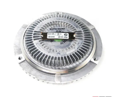

    OE E46 M3 Fan Clutch:
    BMW Part Number: 11527831619
    OE (Behr) Part Number: 8MV 376 733-001
    Mahle: CFC75000P​ (behr and mahle got bought or merged in 2010 https://workshop-heroes.mahle.com/en...-becomes-mahle)

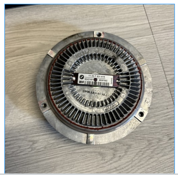

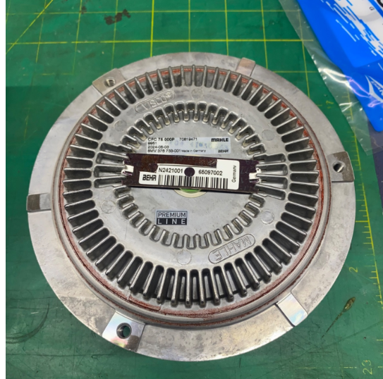

    If you source just a Behr/mahle replacement without the BMW Sticker this is probably what you will get

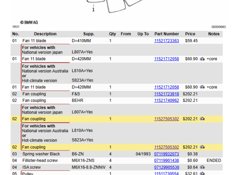

    All the options stem back to this BMW number. 11527505302 which was considered as a tropical fan clutch to European E36s but was the standard fan clutch for E36 M3s USA.

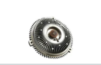

    This first comes back to the HPF and AA upgraded fan clutch.
    https://store.activeautowerke.com/products/e36-e46-sport-fan-clutch-323-325-328-330-m3​
    ​Untitled by Sam DaJam, on Flickr
    Note the very different bi metallic spring design. The reviews are very poor on FCPEuro as people are complaining they are always on so maybe they are that aggressive or it is quality thing and they're bad out of the box. I have not ordered one myself to confirm, but the attached facebook user seemed very pleased.
    I did have an incident where fan hit my crumbling shroud and exploded. My friend gave me free replacement clutch fan and it had an identical bi metallic spring design. It was from a E39 525i. It does have a very aggressive lock up, have used it in the Houston summer no issues. I have also done quite a few track events with it.

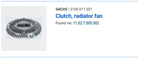

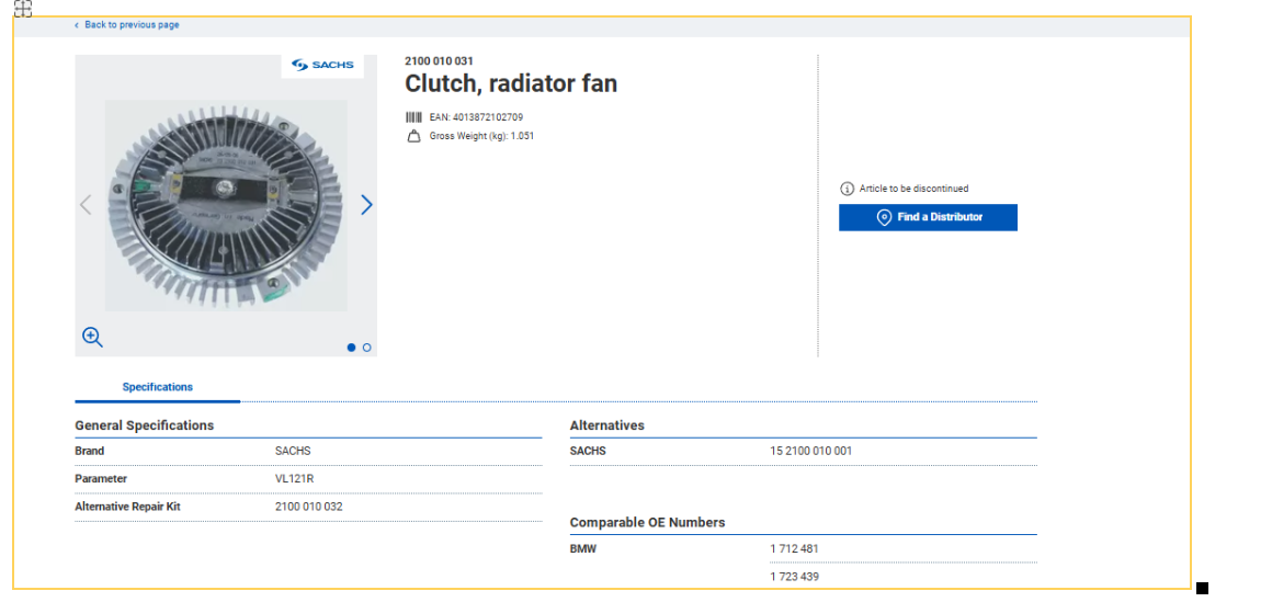

    SACHS 2100 010 031 (E36 M3 Fan Clutch – Confirmed by Anri)

    At the time of this post, Sachs had already marked the 031 as to be discontinued, though stock remained in circulation through various resellers and NOS parts.
    Based on both catalog data and owner reports, it’s a direct-fit part on S54 cars and provides noticeably stronger low-speed engagement without affecting high-RPM behavior.

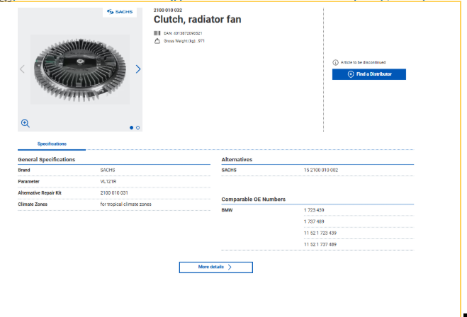

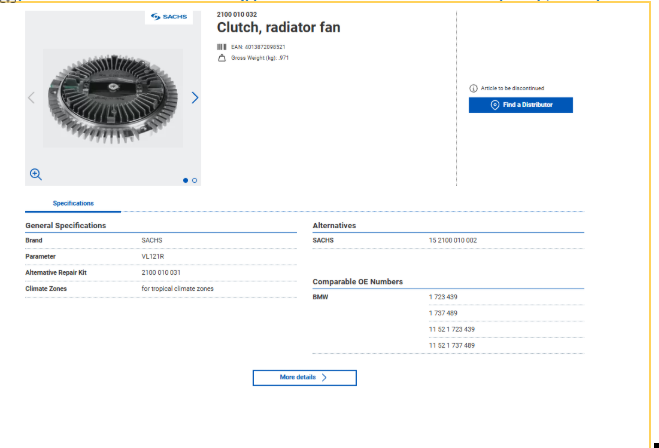

    Tropical Sachs E36 M3 Fan Clutch 2100 010 032
    While researching the 031 fan clutch, I discovered that Sachs also produced a tropical variant — the 2100 010 032. This was a new finding that hadn’t previously been discussed in the E46 community.
    This “tropical” calibration is a Sachs tradition seen on several older models (E28, E32, Mercedes W123/W124, etc.), where the clutch is tuned to engage at a lower air temperature for markets in hotter climates. These are genuine Sachs parts, not aftermarket rebrands, and are identified in the catalog as “for tropical climate zones.” It's also lighter interestingly enough. ​
    https://aftermarket.zf.com/en/catalo...amp;country=ES

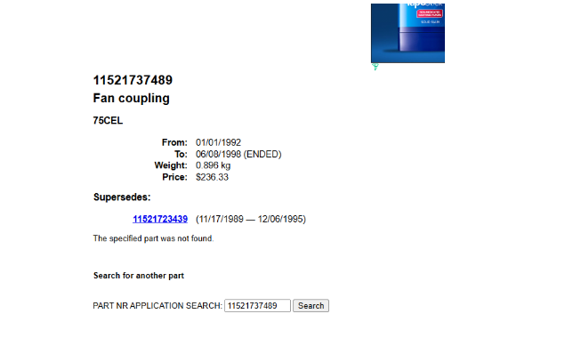

    According to Sachs this is for 11521737489 but it doesn't directly correlate with a vehicle on RealOEM.
    However, it does say it is a 75 Celsius fan clutch on RealOEM so I ordered one from Rock Auto to test. I will report findings once I test it. The 032 is also planned to be discontinued so we are left only with older stock.
    https://www.realoem.com/bmw/enUS/partxref?q=11521737489​

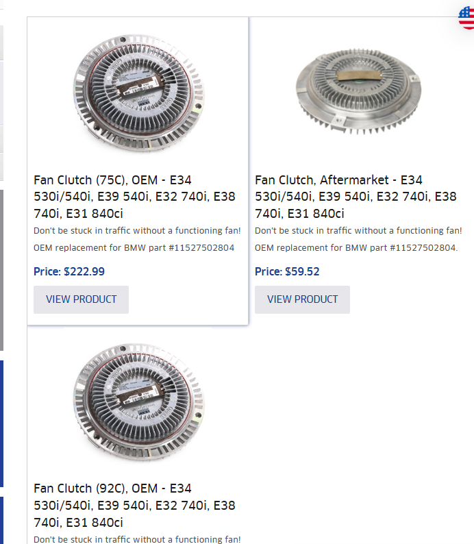

              Bimmerworld might actually be selling 11521737489.
              So while this number doesn't directly tie to anything in RealOEM. However, on various different retailers it says its for 5-6-7 series. Which would tie it to 11527502804, which is a 92C version.
              Click image for larger version  Name:	image.png Views:	0 Size:	240.1 KB ID:	327677​https://www.bimmerworld.com/Fan-Clut...527502804.html
