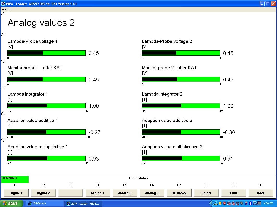

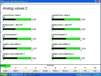

    Mine are sitting around .93 / .91 after 1000 Miles from reset of adaptions
    running MPG 20.6
    When time permits, and next time your INPA, Can you kindly post your LTFT to compare to each other and see who is actually close to 1 etc

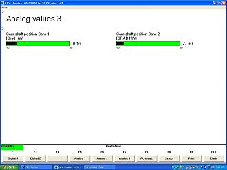

    Click image for larger version  Name:	AdpationsCam.jpg Views:	1 Size:	92.0 KB ID:	329998
    Click image for larger version  Name:	LTFT.jpg Views:	1 Size:	148.6 KB ID:	329999

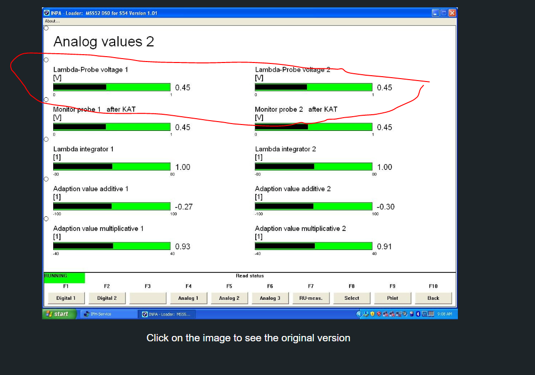

                Are the data in the red circle precat O2 sensors? If they are then the engine was not running in closed loop, as the normal O2 data should be switching between 0.2 to 0.8v instead of sitting perfectly in the middle 0.45v
                The post-cat sensors are also not working. Engine was still too cold?
                Click image for larger version  Name:	image.png Views:	0 Size:	229.4 KB ID:	330974​
                  Isn't the point of this screenshot just to show the adaption values (bottom two rows)? That's the context I get from this post. Not sure what the O2 sensors were doing at the time OP took the screenshot is really relevant here? Unless I'm missing something?
                    LTFT data are valid only if and only if DME runs in closed loop with precat O2 working.
