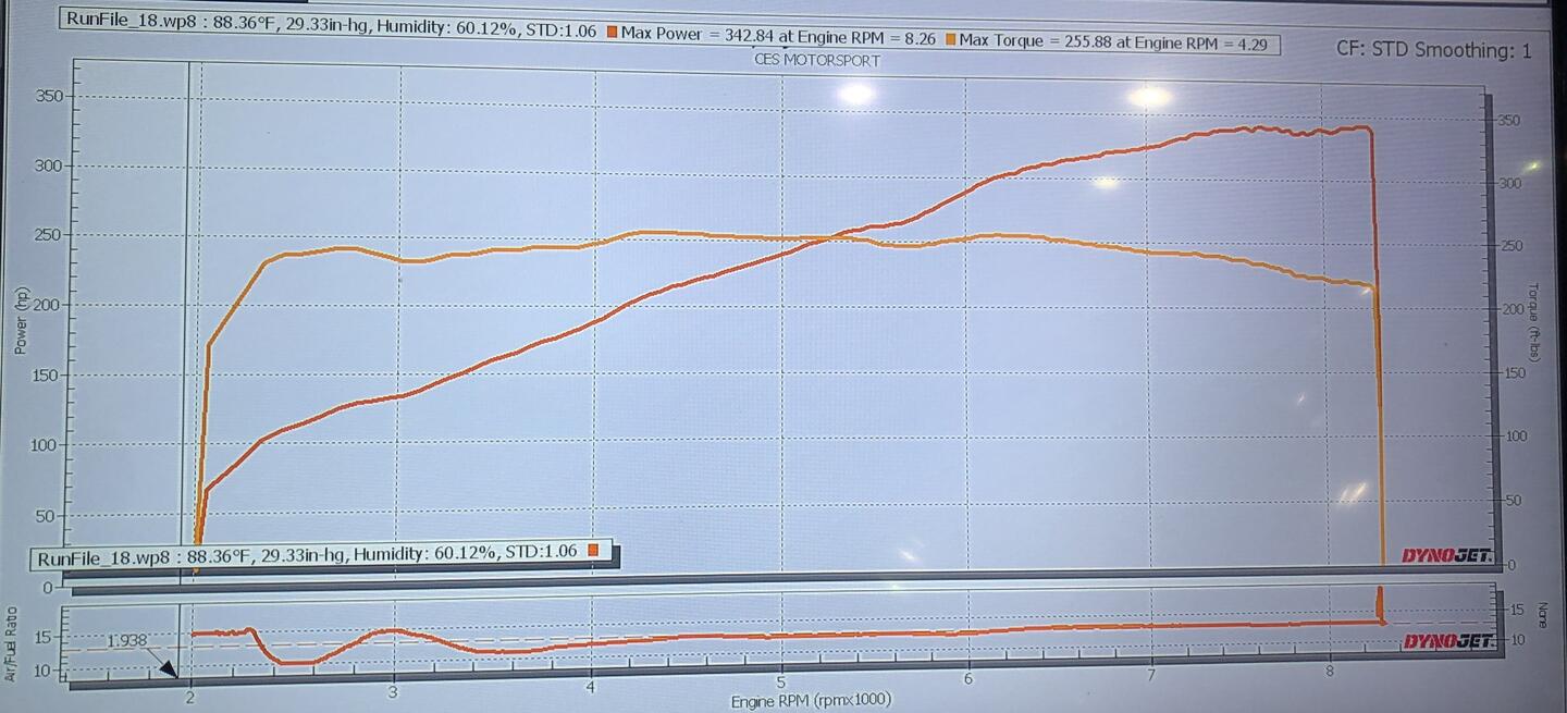

    Tuning with Hassan again

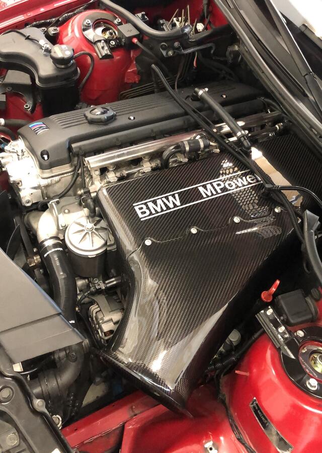

    Installed the TurnerMotorsport CF CSL air box
    Also have Megan catless headers, stock sec 1, stock sec 2 and straight pipe
    Made 342whp/255wtq on 93, car feels a lot quicker than it did before the air box upgrade
    Happy with the results, Hassan never disappoint!

    That’s great numbers for your mods. Good stuff
      Impressive numbers, congrads

                Very impressive that you gained basically 70whp with an airbox, $200 catless headers and a tune. I wonder if the straight section 3 had much of an effect.

                        Makes me wonder if that Turner box is making more power than a Karb....
                          Yeah, I feel like these results are unexpectedly high enough and the TMS trumpet design is different enough that finding a way to do a direct Karb vs TMS box comparison might be very worthwhile for the community. Would have been nice to have had a dyno curve for this car before the box and tune, though, since it's unclear if maybe this is a situation where this design makes great peak power at the top, but hurts the low/mid range? Hard to say.
                            I doubt it, plus there is no delta here versus completely stock.

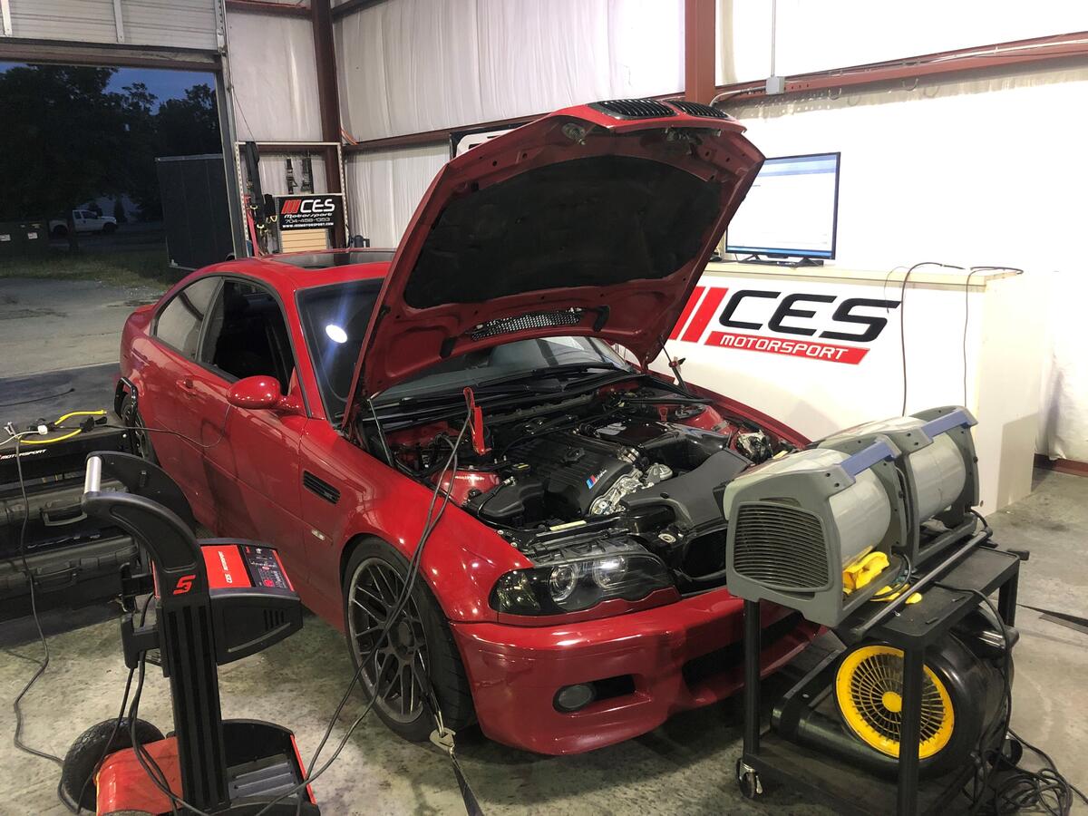

                              Do you mind if I ask where you had the car dynoed? Looks like we're in the same state and I'm looking to go with HassanEido as soon as I finish collecting and installing all of the bits and pieces I'm collecting!
                              EDIT: CES Motorsports. All I had to do was click on the thumbnail
