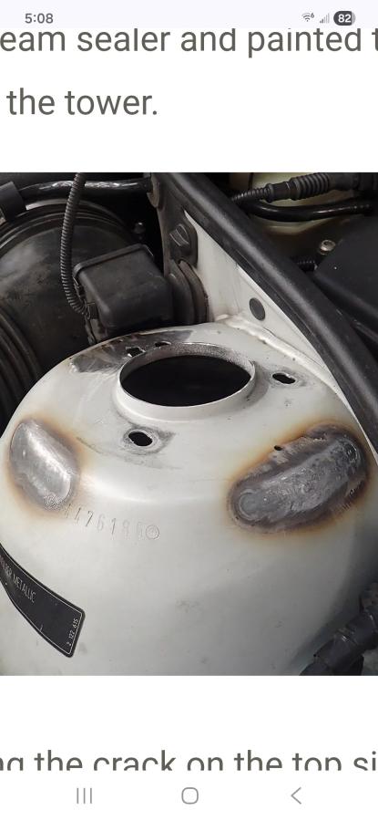

    Pictures from Vorshlag:

    i personally wouldnt weld them.
      Because of how visible they are, I wouldn't weld them unless there were cracks already.

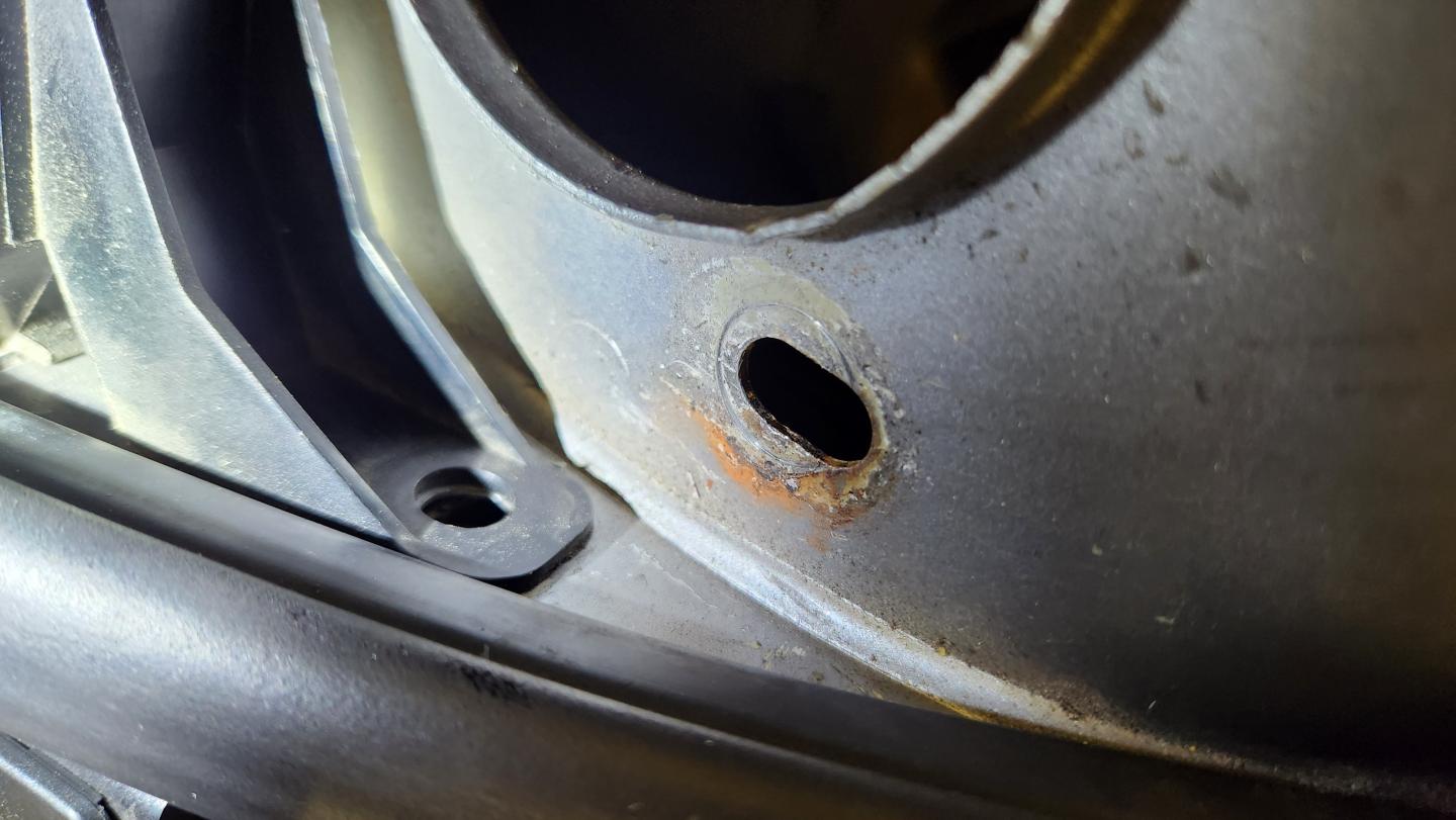

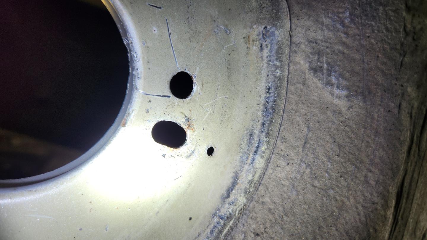

        I have hairline cracks on the rearmost two holes on each strurt tower that have been welded. Unfortunately, the weld did not go through on a the cracks, I can still see some cracks from the bottom but the welder told me he thought it would be OK.

          I just found your other post (https://nam3forum.com/forums/forum/m...tower-tig-weld) and came back here to update my post and saw you already posted.
          Damn dude... that sucks. And it didn't crack where I thought it might have.

              I may just sandwich them in and call in good, I just don't like that I still have cracks on the underside, I suppose I could have the welder come back by and hit those exposed cracks.

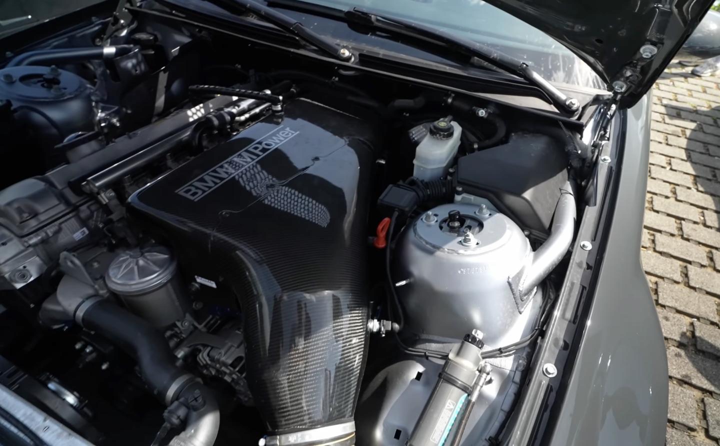

                    ​Team Schirmer E46 with full cage has these plates -
                    Click image for larger version  Name:	plates.jpg Views:	0 Size:	143.0 KB ID:	331631
                      They should have done something similar from factory, this is just such a weak area.
                      I understand with stock suspension it isn't such an issue but just looking at these thin towers hanging out on in space with no triangulation or anything really is just silly.
                        Every time I see the details of one of their cars, it makes me want to go build a dedicated E46 track car. Their stuff is just so well executed.
