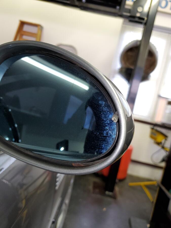

    A lot of M3 owners have experienced the dreaded "rusting" that begins to spread throughout the sideview mirror glass. Here's a quick DIY to show you how easy it is to replace it yourself.
    For this DIY, I replaced my driver's side glass. First, an example of the "rust" that spreads underneath the glass (top-right of the picture - pardon the dust, pollen season has officially begun):
    Click image for larger version  Name:	1.jpg Views:	0 Size:	22.8 KB ID:	3655

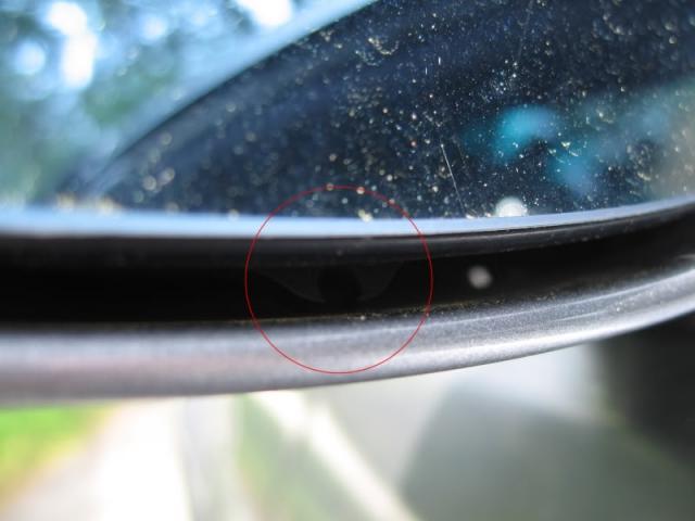

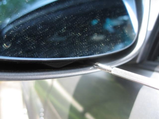

    First thing to do is to tilt the mirror up, which will expose a small tab underneath the mirror, circled in red:
    Click image for larger version  Name:	2.jpg Views:	0 Size:	29.2 KB ID:	3656
    Take a small screwdriver, and place it in the hole. For the driver's side, I pushed the tab to the right - towards the car, which didn't take much pressure at all, later model cars the glass just pops out:
    Click image for larger version  Name:	3.jpg Views:	0 Size:	30.5 KB ID:	3657

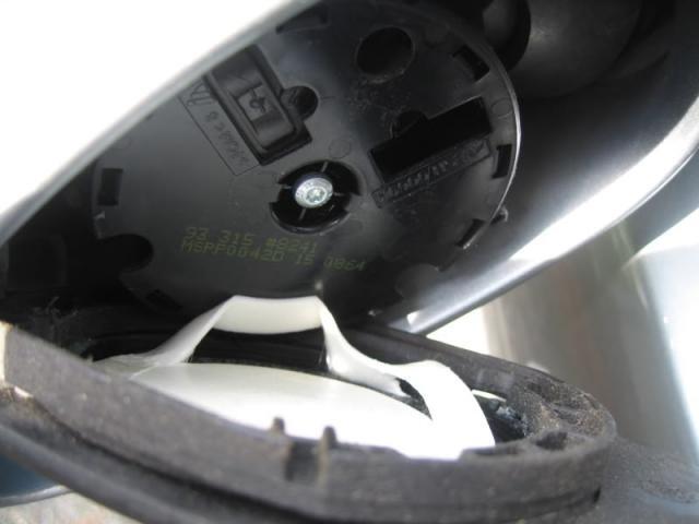

    This will unlock the retention clips that hold the mirror in place. After you've done this, start to slowly pull the mirror out of it's housing. You'll hear the adhesive begin to pull away as seen here:
    Click image for larger version  Name:	4.jpg Views:	0 Size:	25.0 KB ID:	3658

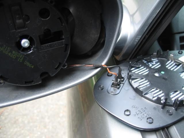

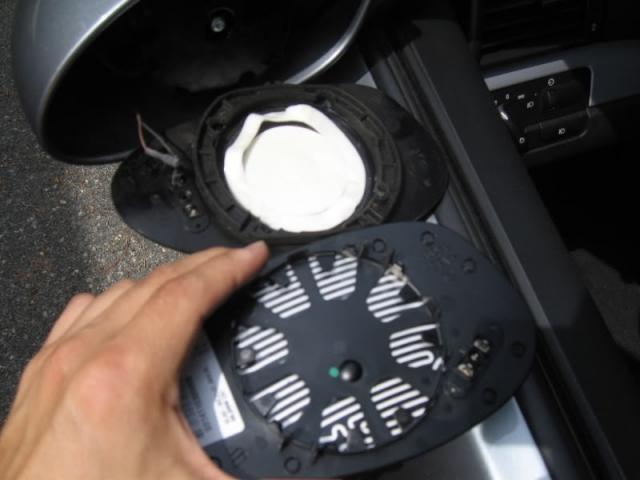

    My new mirror is a new version, which doesn't have an adhesive back and the electrical contacts have been moved to the other side:
    Click image for larger version  Name:	5.jpg Views:	0 Size:	29.2 KB ID:	3659

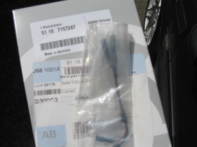

    The new mirror will come with an extension cable assembly that will allow you to plug into the existing cable, and move the cable to the other side of the mirror (Wires may need to be purchased separately double check before purchasing):
    Click image for larger version  Name:	6.jpg Views:	0 Size:	21.2 KB ID:	3660
    Click image for larger version  Name:	7.jpg Views:	0 Size:	33.2 KB ID:	3661

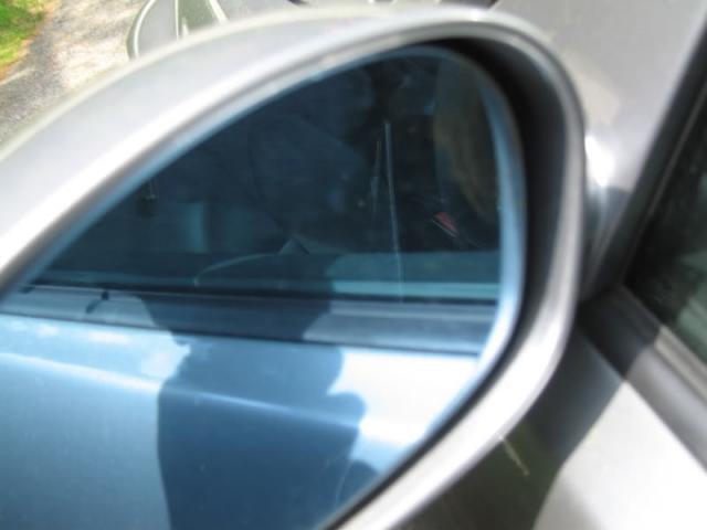

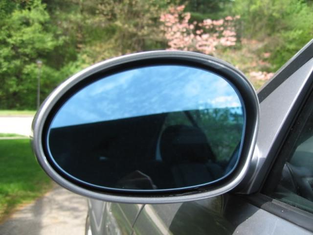

    After you've connected it, simply align the mirror in place with the clips and push into place. That's it, enjoy your rust-free mirror!
    Click image for larger version  Name:	8.jpg Views:	0 Size:	36.9 KB ID:	3662
