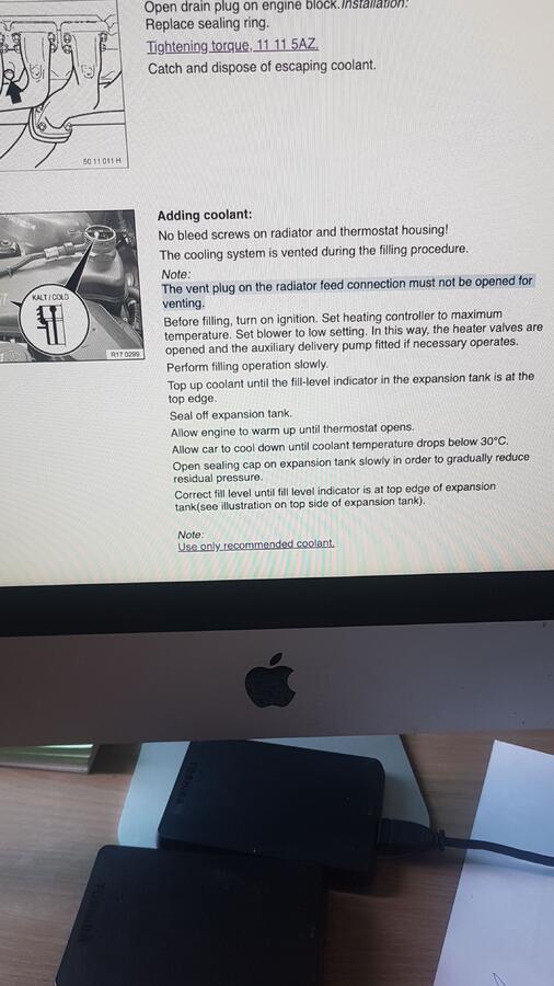

      I was planning to do radiator flush for the e46 m3 as well,I was reading the procedure on newts.info
      then I stop on the last step where they are asking to don't remove the bleeding secrow.
      are this information correct???? Click image for larger version  Name:	IMG-20200601-WA0014.jpeg Views:	0 Size:	61.8 KB ID:	33783
        Our system self bleeds (like the clutch) with the e-tank at the highest point. You don't need to mess with that little bleeder screw on the upper hose elbow to the rad. Squeezing the upper hose seems to help move things along. Also, drive the car and get it hot, when you're done. Once cold, like the next morning, you'll usually find you have to add some more water in the e-tank.

            Thank you I used to remove that screw every time I bleed the system. That what I saw on youtube DIY and what is make that Strange no one of the m3 owners noticed that !!!
              Ya it was like an e36 holdover or something. I do miss the bottom drain on the e36 radiator though.
