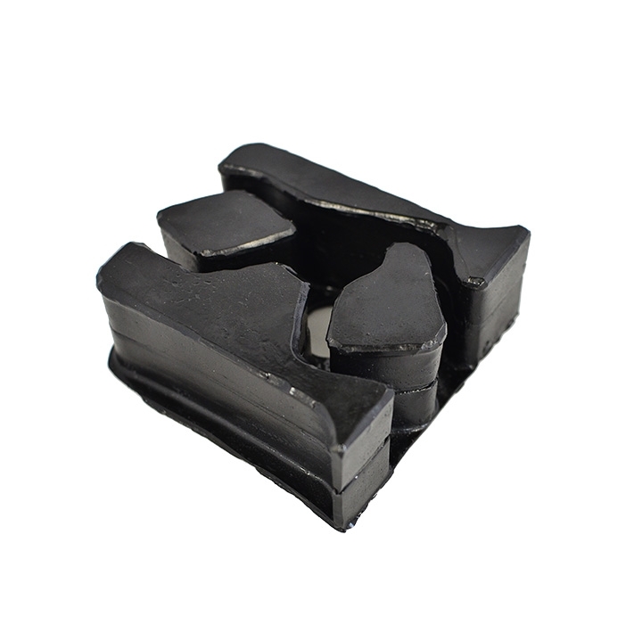

    Any suggestions on a stock fitting heavy duty exhaust muffler hanger? I know that RevShift makes an insert for it. And bimmerworld makes a new mount with a round polyurethane mount. I'm just wondering if there's any thing else worth examining on the market.
    here's the RevShift insert if anyone hasn't seen it.

      If the stock ones can hold up the heavy ass boat anchor, I think they're good enough. You can fill in your current ones with hi temp silicone to replicate the revshift inserts. I wouldn't do poly, I imagine it'll transmit too much noise and/or vibrations.

        I actually have Genuine BMW hangers now. Filled with rtv but after 9 years the single hanger on the passenger side partially broke. Since that one handles a lot on it's own figured I'd see if anything new has made it's way in the market worth looking at.
        FCPEuro actually sells the HJS (based in Germany) hanger for $19.99 and being from FCP it'll have lifetime warranty so that's a plus. May just buy that and fill with RTV again. Although not sure if that will void the warranty if prematurely fails. The RevShift poly insert I would think is more pliable than the rtv ones I had for many years. Trying to hear what others are doing lately. Thanks

                    I have the revshift. But only bought one. Forgot which hanger I put it on but on the one most prone to breaking I think it's the driver side front? But no vibration or noise.
