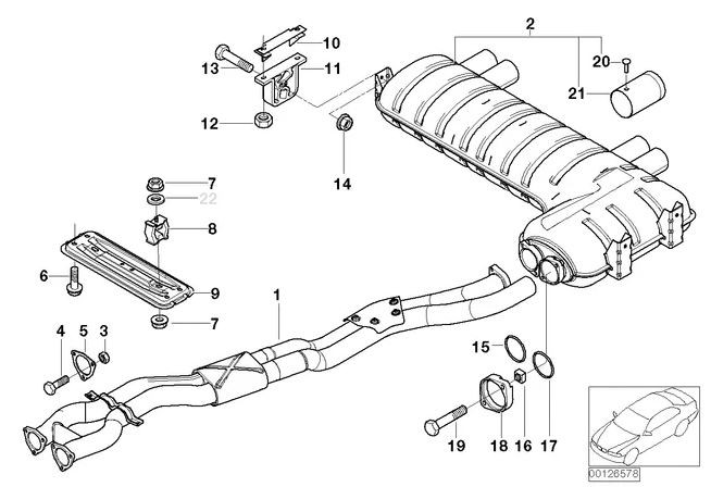

                          I wasn't kidding-- they're directional, and lots of people install them backwards.
                          I have the SS street-- which is only ~3 lbs lighter than stock.
                          Note how the part where it bolts to the muffler is closer to the back of the hanger. You can force it the other way around, but they fail faster if you do.
