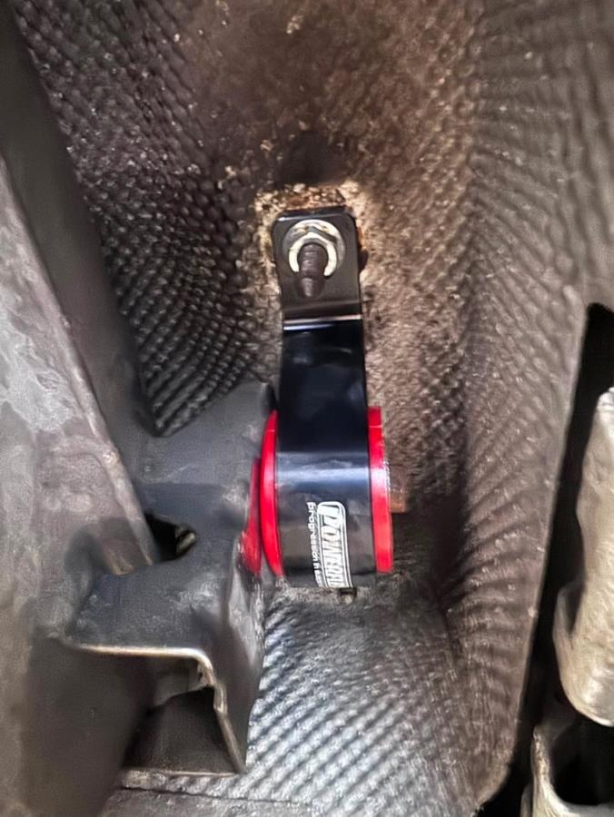

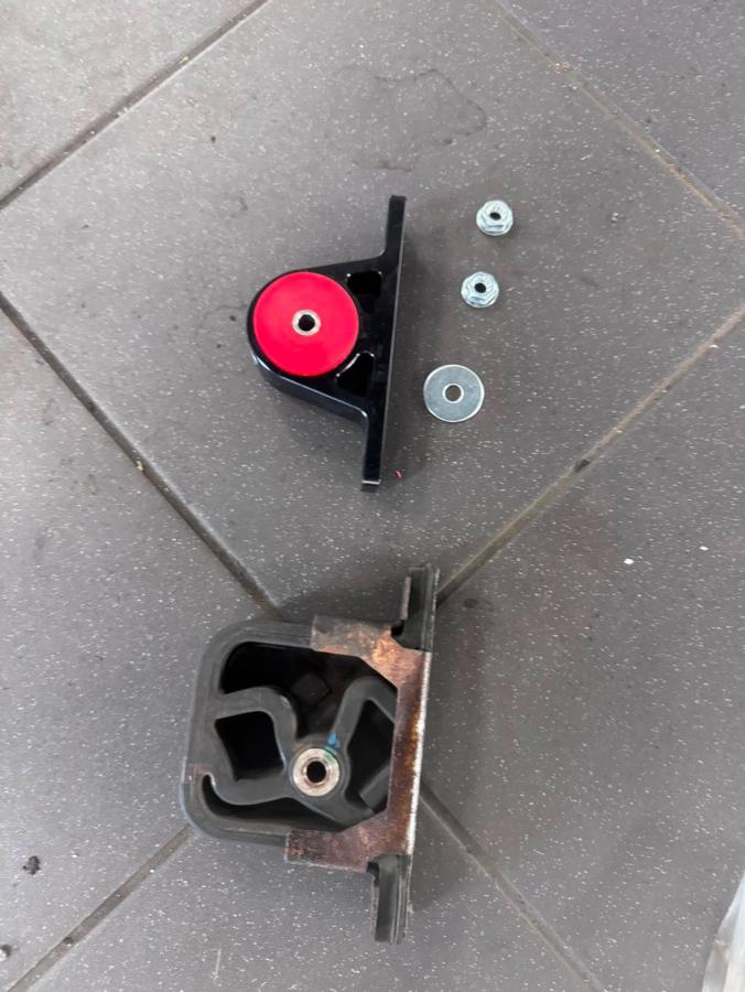

                My mechanic just sent me these, they’re a bit blurry but you get the gist.

                Hopefully I won’t have a problem of this sort in future and therefore won’t have to post on this thread again…

                  Looks good. Yeah let us know once you drive the car if there is any NVH.....

                    Picked up the car from the garage today.
                    Drove home (which is ~25 miles) and can confirm there is no new/additional NVH.
