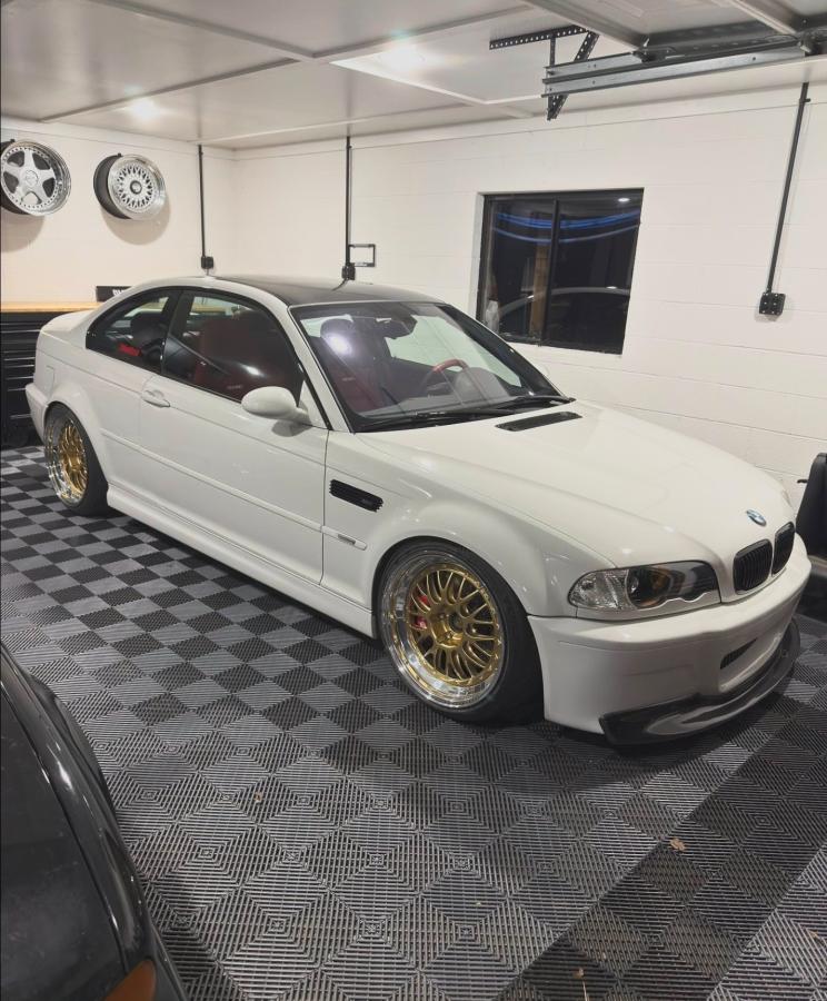

Anyone running this, or close to it?
I know 18x10 +25 is common, but I can't find any pics of 19x10 +25 square

It can be done with ease on the rear, but the front is going get tricky. Compared to my fronts which are 19x9 et28 with 2 degrees camber you're going to have 16mm more poke and be inset 10mm more.

They're off Paul Ehrlich's car, and he was running 19x11 +25 in the rear, and 19x10 +25 in the front. 275/30 & 245/35
I can have them re-barreled, but IDK what size to go
I was going to try to run 19x10 +25 square.

My storage setup on my NA car is on squared rear OE CS/L wheels so that's 19x9.5 ET27 all around 275/25/19.
Slight rub at full lock but the car runs -3.5 up front and -2.5 in the rear and my ride height isn't broccoli'd.
