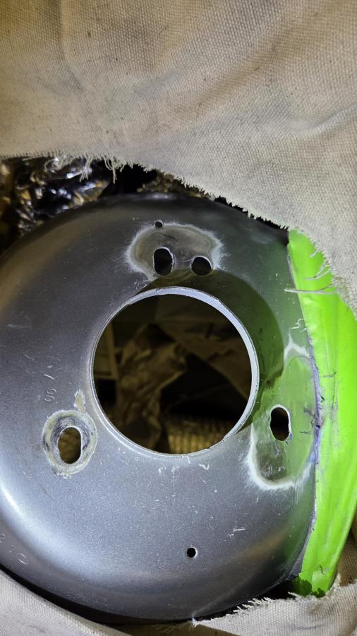

    I had my strut towers repaired and I have used some gray POR-15 primer/topcoat for the underside, it doesn't match well buts that's OK.
    For the topside I'd like to attempt to get a close enough match that's acceptable, Id like to do this on my own. Worst case I will have it done properly down the line.
    I see many different options for Silvergray Metallic (A08) in spray can form. I just wondered if there was a particular brand that is considered better than others.
    Also, I see that the engine bay paint is different from the body paint, less gloss. I have been doing some reading, man that's going to be hard to match.
    Now also questioning my use of self-etch vs. epoxy for the primer on the underside of the towers, this car won't see much rain though.

            Think I'll just choose a "quality" A08 aerosol, 2k primer (maybe 1k?), and some semi-gloss. I am learning about epoxy vs. self etch, and how I should have used expoxy primer for the underside as opposed to self etch.
            I am contemplating whether or not I want to just paint the exposed areas or paint the entire tops of the towers.
            I have an RE strut bar comming, I may trace around the base of it and just paint that area. There is no way it's going to match.
            Unfortunately I have a few little areas where I zipped off paint when the dremel bounced around that won't be covered by the brace, I just need to accept it won't be perfect.

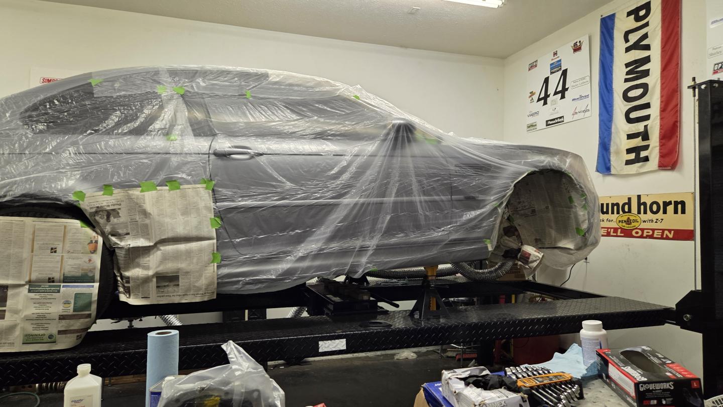

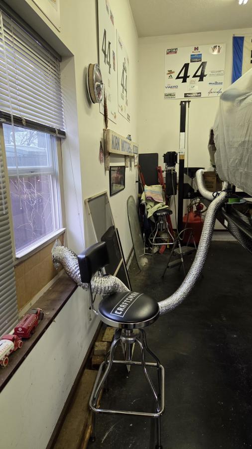

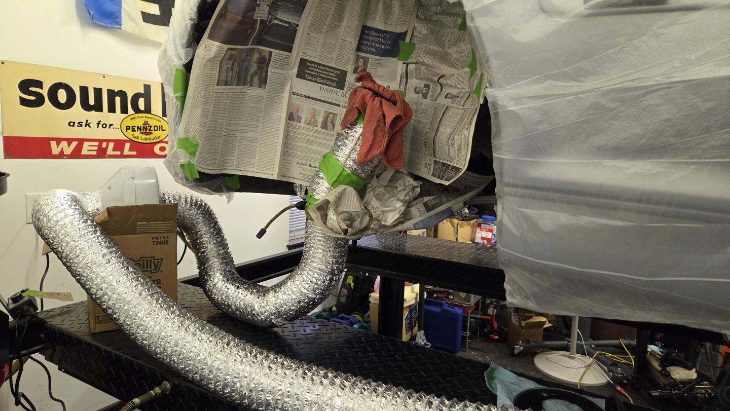

            I did find a great way to paint in the heated garge while exhausting all the paint fumes outside into the winter weather. Inline fan I had laying around finally came in handy!
