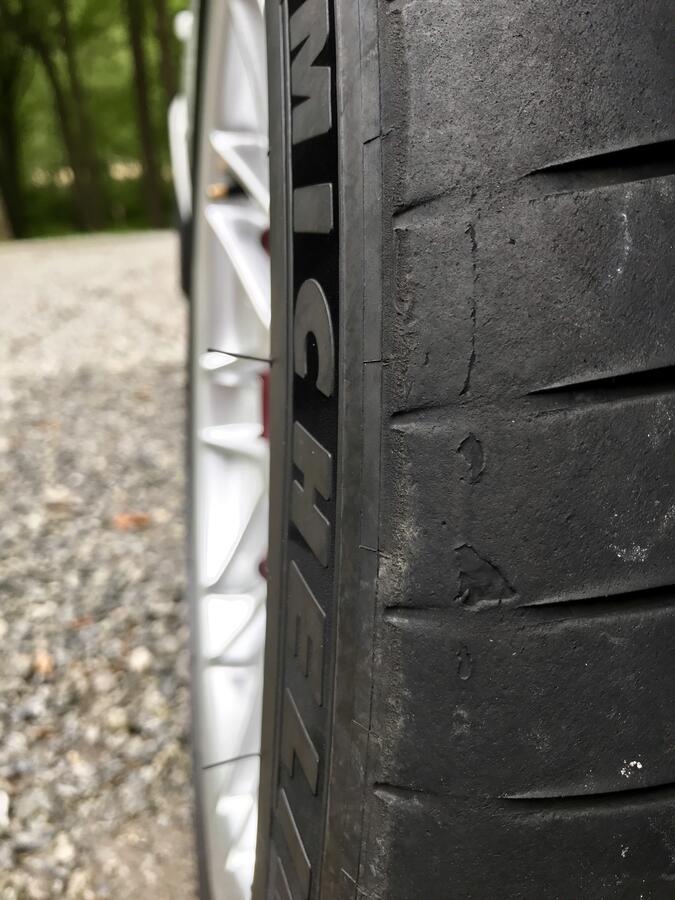

    Need help with tire setup on E46 M3 on Michelin PS4S tires.
    - All suspension components are in great condition.(checked religiously)
    - 265/35/18 on 18x9.5 wheels
    - 2.9 degrees of negative camber, 0 toe, stock caster
    - 38 psi hot

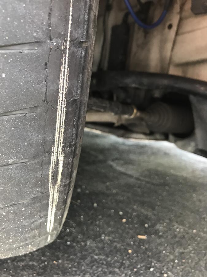

    The inside of the tires are on metal cords, outside is blistering. Middle on the other hand has 4/32nds. This usually means under-inflated but at 38 psi thats hard to believe. Rears are wearing perfectly, fronts are the problem.
    Ideas?

    Looks like toe wear combined with excess negative camber. Understand why you have more negative camber. I'd check your ball joints and the tie rod end.
      All suspension mounting points are in perfect condition, most are monoballs.(all double checked) The car is not a daily, its usually driven aggressively on twisty roads like Tail of the Dragon.
        It looks like toe wear...not sure what else to say except redo the alignment.
          This one is a very odd one. How much mileage on those tires? Blistering on the outside is indicative of positive camber wear, but then you still have corded inners. How much caster are you running, perhaps -2.9 deg static camber on the front with some toe (though I know you say you have zero) caused the inner tires to wear quickly, but then pushing it hard on the mountains (with very little caster) caused outer wear? Or, perhaps there is some compliance somewhere that is contributing to excessive camber/toe compliance, though you did say that all your suspension components are fine.

            Caster is maxed on Vorshlag camber plates. I have been running a very similar setup for a long time, what changed recently is the tires (PS4S compared to previous RE71) and softer front spring(to get flat ride). I am starting to think the softer front spring is causing more bump steering problems.

              Cording is usually a toe + camber issue. Too much toe alone would cause exacerbated wear across the whole tire. Camber puts it on the inside only like pictured above.

                    The inner wear is definitely the camber. -2.9* for the street on Super Sports is over cambered. I would suggest throwing it on an alignment rack and seeing where your measurements sit. If the toe really is at 0, then that rules the simplest cause out.

                            Are you feeling any slop in the steering? Could be inner tie rods. Could be FCABs.
                            I'd check every nut, bolt, and ball joint. You are getting excessive toe SOMEHOW and because it's on both inner and outer extremes of the tire, it's likely something loose or shot.
                            I have corded countless r-compund tires (DOT radials) on the track trying to eek every last cent out of a set of $1200 tires. The only time you get wear like what you are describing is if something is moving that shouldn't be. If it's one tire, I'd say balljoint, tie rod end, or a camber plate is moving on you. But you said "tires" so my thought goes to the center of the car. Have you done the simple checks like feeling for lateral movement by grabbing the left and right side of 1 front tires and trying to move / shake the tire along that axis? Have you looked at you front "subframe"?
                            Check anything and everything that is somehow connected to steering. Everything.
                              PS. Bump steering that bad shouldn't be springs. Springs shouldn't cause bump steer unless the car is rolling MUCH farther than it was with stiffer springs and you're now uncovering a seriously flawed steering arm/tie rod angle.
