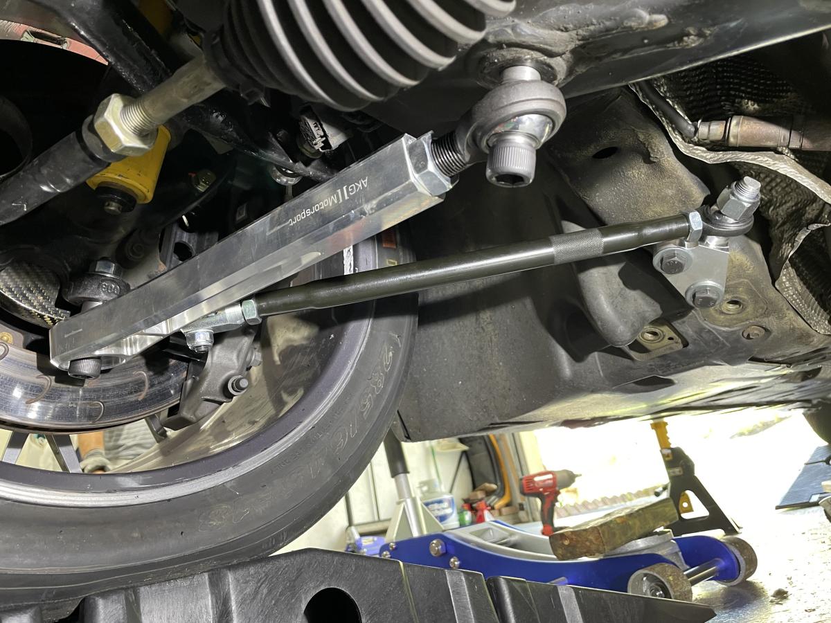

      Generally we've found the further you get away from stock components the shorter the life span and on a tie rod or control arm bolt the moment of failure can be instantly catastrophic.
      Email to [email protected]
        Do the control arms suffer the same bending force as the tie rod?
        I think the tubular arms can be a massive performance upgrade. I am considering the MRT kit knowing it will need to be replaced periodically.
          I would imagine so, the AKG arms use a hardened through bolt that you can replace regularly. The VAC design uses a soft cnc'ed stud that could break. I have heard of Bimmerworld failures, but to be fair Feffman has also had an OEM failure. I think the key is replacing regularly no matter what kit you get.
