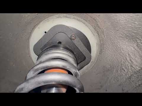

    Seeing this, I went to investigate, but I'm admittedly running out of new parts. So it's easy to now look at the strut/shock assembly (AST 5100 + Turner street camber/caster plates). I remove the strut bar and notice the top bolts can move freely with the car on the ground. I'll admit a little ignorance - I don't fully understand how this camber caster plate works, but I'll tell you this: it seems I can move the top mounting plate completely freely on the passenger side, but can't on the driver side. You can see this movement in this video: https://youtu.be/GFySq1A7ppw.

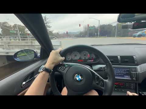

    The driving noises is 0-20 seconds, and you can see the movement from the top and bottom at 20-45 seconds, and the mild squeak I can create by grabbing the wheel to put a y-axis load on the wheel. In the video at 45 seconds, you can see that there's this odd amount of play you can get with very little physical effort. I'm also a man with a problem in the hunt of a problem, so I can't tell if this is confirmation bias. But when I look at this NAM3 link about the camber caster plates, I still can't discern how it mounts to the strut and understand there should be some movement allowed, but I don't think this much with weight on the corner should be permitted
    I'm a bit of a loss. I can't just keep throwing this thing at shops who just want to toe this thing in. Looking for suggestions on what to investigate, or confirmation that a camber/caster plate shouldn't be able to move like that. Like perhaps the bearing is blown, I don't know . But if the top can move, that would definitely explain my variable toe. Or if the bearing inside is blown, could explain my noise. Just running out of things to investigate, and the noise is very weird and doesn't sound metal on metal.
    It's very hard to capture irregular toe characteristics, but the car will tend to pull to the left under braking and pull to the right under cruise and acceleration. You can see the car basically want to steer into a ditch under normal braking, and then in the next clip, you can kind of see the turning right countersteer under braking.

    Umm you should not be able to move the passenger side camber plate like that. Why is that not tightened?!Torque that down and report back.
      I second this. You should not be able to adjust the camber with the front end on the ground.

        Sorry. I should have clarified. It's loosened the bolts because I was removing the strut bar to isolate the noise. The other side, driver, fully unbolted, was unable move up and down. So I didn't know if that represented top hat failure.
        It was torqued appropriately before driving again

            Running the same camber plates as you and mine behave the same. Studs on the passenger side move around freely when the nuts are loosened, but the studs on the driver side stick and require some persuasion from a mallet to scooch over. The studs are designed to be able to move independently from the plates so that you can achieve more camber than stock.
            Leading theory is that the driver side camber plate is slightly twisted in relation to the strut tower holes and that causes the studs to bind a bit. I haven't actually made any effort to confirm if this is the case or not since the car aligns up just fine.
            Regardless, the only way I think this behavior could cause your issue is if the studs are binding so much that you can't achieve the required clamping force between the camber plate and the chassis.

              Not sure if the springs are loose at full droop but check that the bearing in the camber plate moves. Those turner plates use a piece of shit sealed roller bearing which is not at all sealed. Same with the ground control street camber plates. The bearing uses a plastic race while allows the bearing to get contaminated and then can seize or just fail. I had a GC plate on my E90 M3 and had to service the camber plate annually or it would start clunking.
              When you tap the brakes the front end dives. The spring is compressed and the camber plates should allow independent rotation of the spring. That is the only thing I can think of that would turn the steering wheel like that.

                  I potentially suspected that the driver was just seized a bit. But again, I was basically looking for confirmation bias on the passenger after I was able to isolate it to one side.​ Wheel bearings show no signs of issues and no wheel spacers

                  The springs could be spun at full drop with some resistance. There is a helper spring and I suspect this was by design. I started to look more closely at the bearing and it's my top suspect.

                  I made this thread when things went from bad to worse. The variable steering turned into this clunk, and it has rapidly gotten louder. The warmer it is outside, and the more road oscillations I'd drive on, the more prominent the noise would be. The video above is without a sway bar installed (how I was able to isolate to one side). You can feel it in the chassis as if something is moving. When I removed the sway bar, I checked the torque of every other bolt with no irregularities. the duratino of the noise would pick up with speed, so I ruled out wheel bearings (along with the complete absense of any road howl).
                  Solution was found:
                  Feeling like I was at a dead-end, there was really only one more potential culprit: the strut assembly. Admittedly, a bit impulsively, I bought myself a nice new suspension, but it's 5 weeks out. The car is clearly no bueno and every time I drove it, I felt it was going to fail in some catstrophic way. So to at least bring validation to my theory and to make sure the car felt self to move around.
                  I bought some used E46 struts. Just some garbage worn crap. I put it in, pulled the coilovers out, and went for a drive. Most reassuringly, the clunk noise is gone and the car no longer falls apart. Additional bonus, the car is absolutely hilarous to drive. With the front stock soft (140lb?) and the rear with a 560lb spring, the car is comedic. In a driveway, you don't feel the front even go over any oscillation and then the rear goes over. Under acceleration, the entire car bucks up. For me, this is the best ending. And yes, I understand this setup is completely unsafe to be pushed on. It's just to keep the car mobile, no backroad driving. It's just to hold off until the new stuff comes in. Then alignment, new front tires and the car will be ready for some well overdue fun drives.
