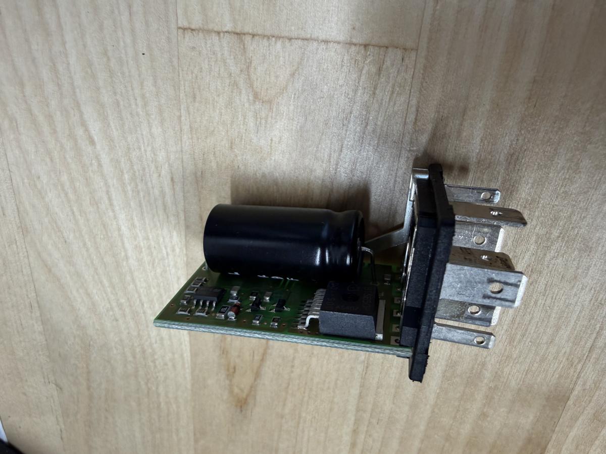

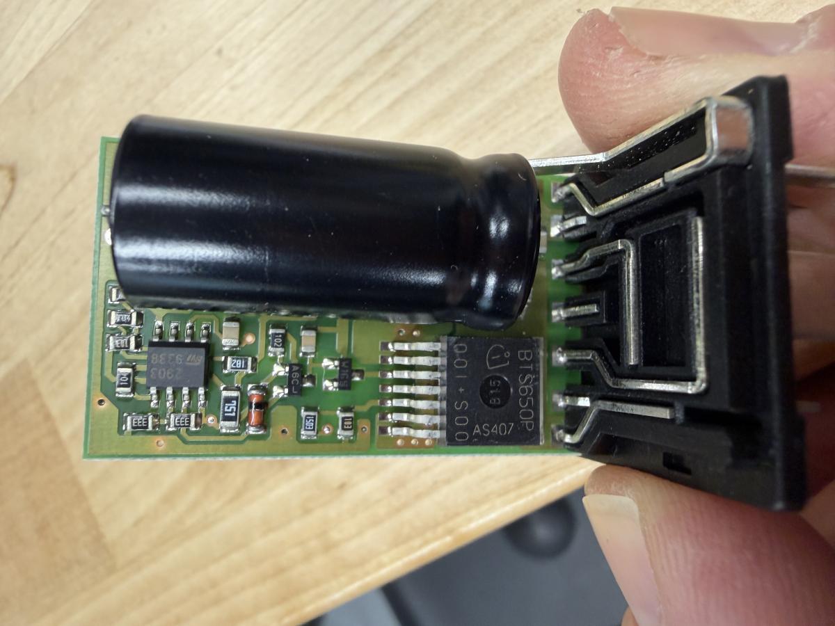

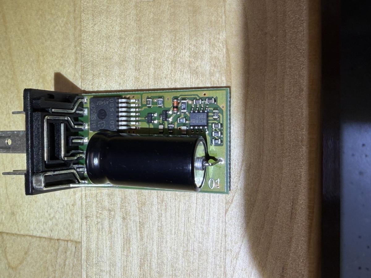

              For those interested in what’s inside the failed module — I opened it up.
              The power switching component is a BTS650P — an Infineon Smart High-Side Power Switch.
              Also present is a 470µF electrolytic capacitor dated 02.04 — original to the module.
              Visual inspection of the PCB shows no catastrophic failure — no burnt traces, no obviously failed solder joints, no visible damage to the BTS650P package externally.
              Curious whether anyone with electronics experience recognizes a known failure mode in this specific component on high mileage applications.​
                #37

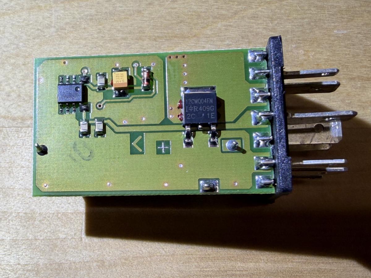

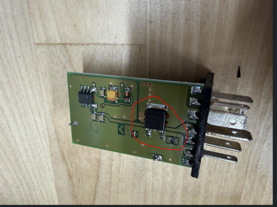

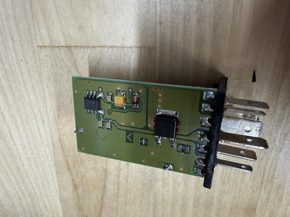

                The BTS high side switch (also called semiconductor relay) has an N-channel power FET to drive the pump. 14v supply is connected to pin4 and the body soldering tab (also for heat dissipation), and I bet this pin4 is connected to the 470uF for stabilize the 14v supply on the board. Since there is long wire going from 14v source to pin4, so w/o the cap acts as reservoir the BTS would be starved from 14v whenever it switches on the power FET to drive the pump.

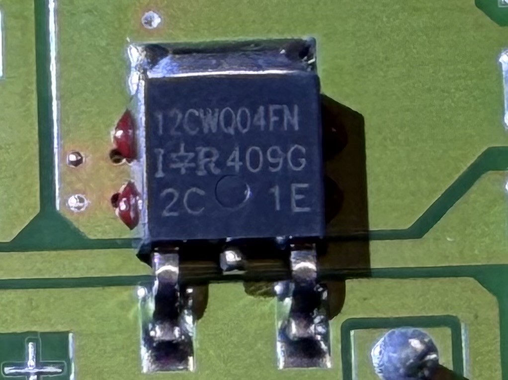

                The 3 pin device below I think it's a dual diode connected to the BTS output for the flywheel effect when driving a massive inductor (the pump motor). Without the flywheel diode to keep the inductor current continuously flow even when the FET turned off during pwm cycle, the inductor current would kill the FET fast, based on Lenz law. Can you read the part # on this part?
                The square wave PWM voltage will be filtered by the pump motor inductor coil, so if you can display the current on the scope then it's DC current with some ripples but not the whole pwm signal.
                If the BTS is partially damaged as in your case, put a finger on the device while it's driving the pump and feel the temperature. Cool is normal and hot is bad device.

                  From the pics it's fairly easy to repair a damaged e-relay, so people should save them for repair if they are NLA, or too expensive. Parts are standard and availlable from Digitkey or others.

                    sapote The 3-pin component is a 12CWQ04FN — International Rectifier dual Schottky rectifier, common cathode, 40V 6A per leg. Confirmed freewheeling diode exactly as you predicted.

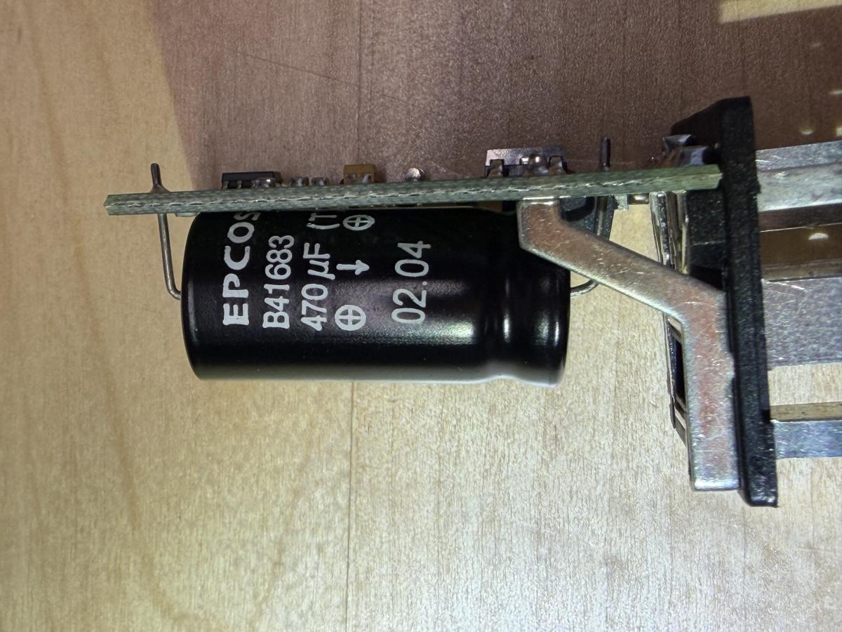

                      From what I can document on the failed module from my 2005:
                      ∙ BTS650P — Infineon Smart High-Side Power Switch
                      ∙ 12CWQ04FN — IR/Vishay dual Schottky rectifier, 40V 6A, DPAK
                      ∙ EPCOS B41683, 470µF electrolytic — voltage rating not visible, dated 02/2004
                      Would you be willing to confirm the complete component list including the capacitor voltage rating? That information documented here would be genuinely valuable for the community long term.​

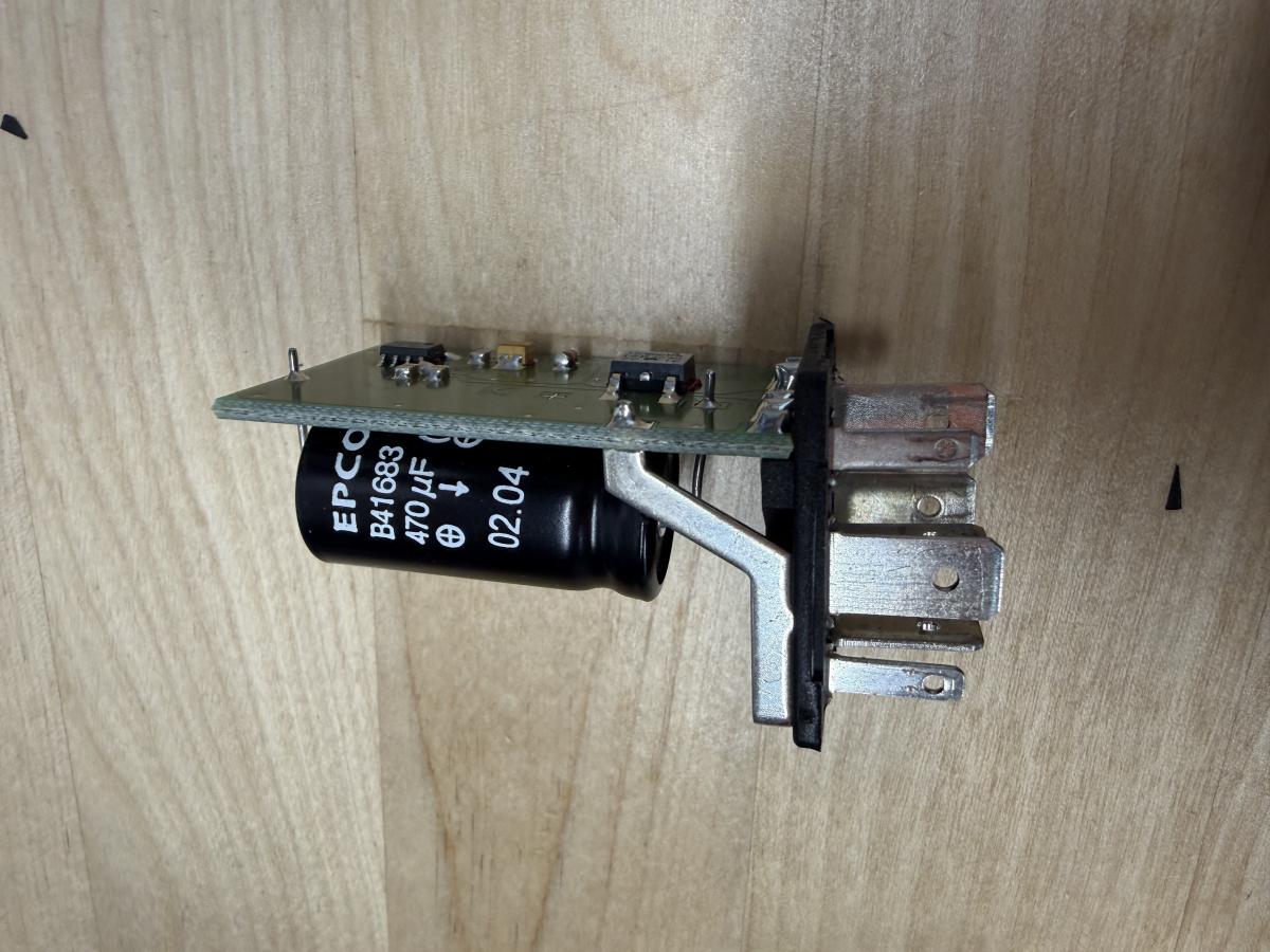

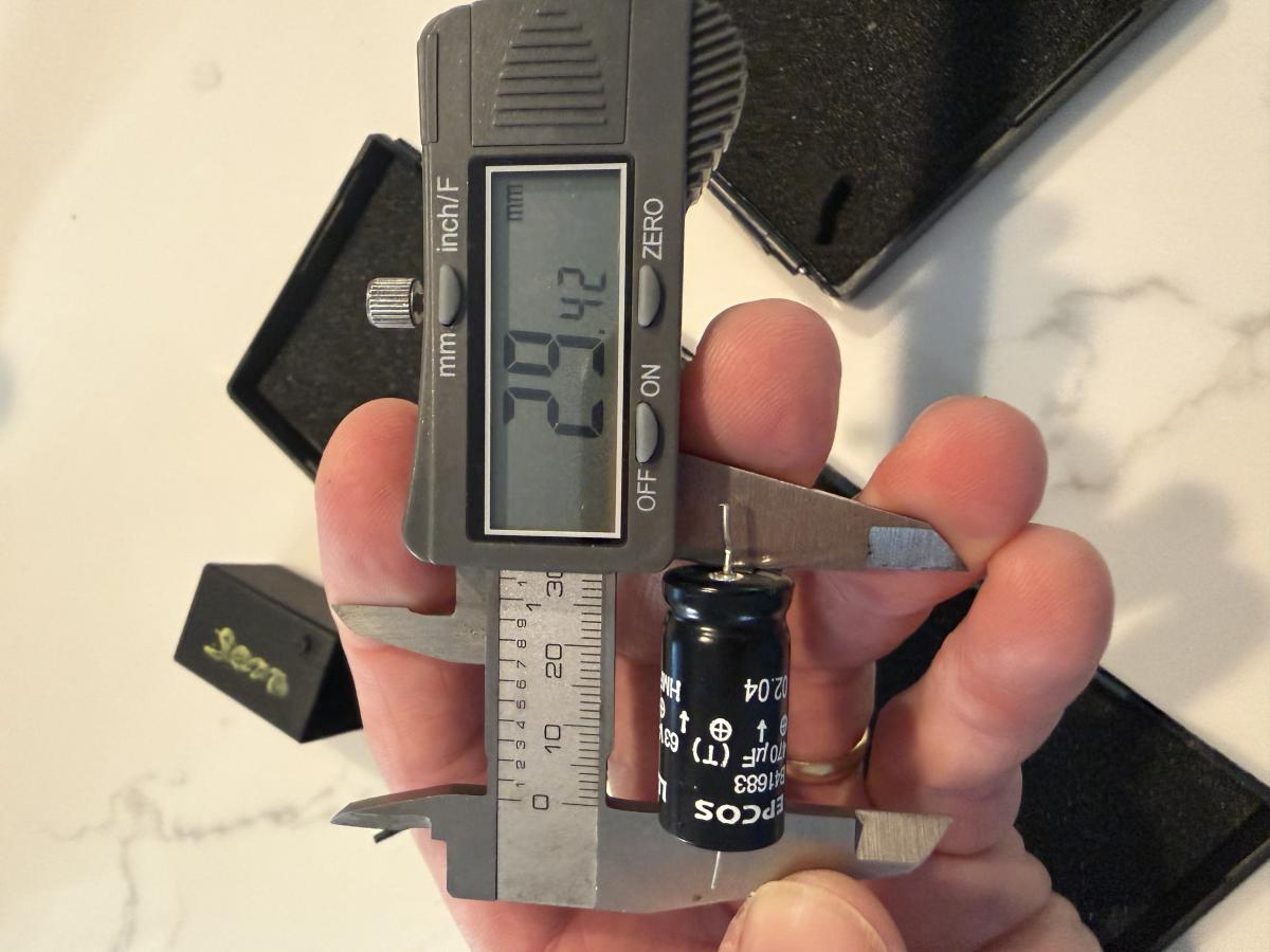

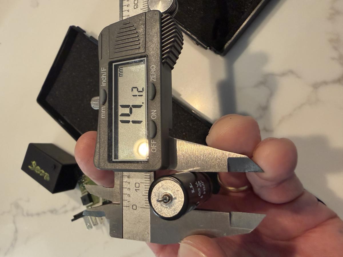

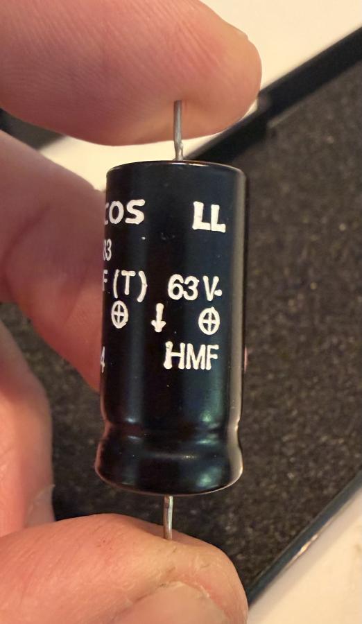

                              I ‘disassembled’ mine so you guys could see more.
                              Measurements checked using (my cheap) digital calipers — average measured diameter 14.2mm, length 29.4mm. Nominal 14 × 30mm. Voltage confirmed 63V visible on reverse side. Matches B41683 470µF 63V exactly per the datasheet Terra shared.
                                #45
                                How far apart are the holes on the PCB would you say? TDK / Epcos' closest replacement would be B41693, but seems like the 470 µF variants are 39mm long (and 18-20mm diameter).
                                Otherwise there are alternatives such as https://www.mouser.com/ProductDetail...MAL213828471E3 -- though most of the alternatives I'm finding have somewhat higher ESR. How much that matters for this, I'm not sure.
                                For a lot more money some of the Tantalum options are interesting. But I think I'd just swap to a mechanical relay before going down that path.
