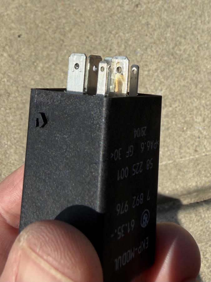

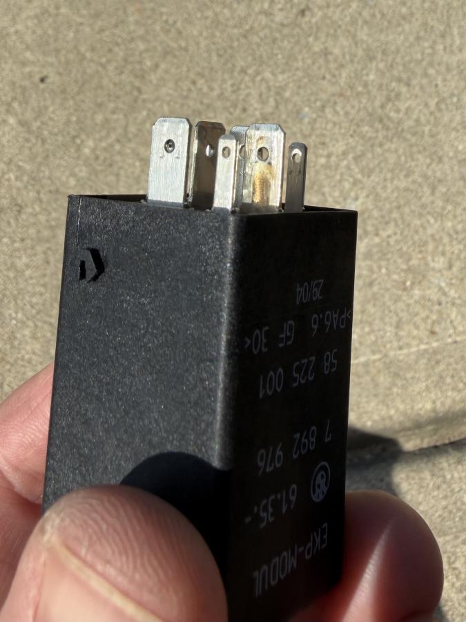

                  Fuel Pump Relay:
                  Pin 5 has an odd stripe on it. Pin 8 has discoloration on one side (in sunlight and shop lights, with naked eye and iPhone camera)
                  Ground wire tested AOK (Ohms)

                      Absolutely there was no arcing ever happened in these relays. US cars have the semiconductor relays using power FET to drive the pump instead of metal contacts in mechanical relays.
                      What can kill your relay: check if the heavy GND wire (from the ignition coils harness) is bolted tight on the engine head, exhaust side. Loose or bad connection can kill the relay.
                        Thanks sapote . You are correct. I learned that contrary to the term “fuel-pump relay”, used by my code reader, the EKP Module uses Power MOSFETs (FETs) to drive the pump. This allows the DME to use Pulse Width Modulation (PWM) to vary the pump speed based on load.

                          The EKP module (aka fuel pump relay). Specifically a 21-year-old unit pulled from a donor car. Visual inspection revealed oxidized high-current blade terminals and discoloration on Pin 8. Hypothesis: the MOSFET had degraded sufficiently to reach thermal failure under sustained high current demand — at the one hour highway mark — while still functioning normally under light load conditions.

                              The EKP module (aka fuel pump relay). Specifically a 21-year-old unit pulled from a donor car. Visual inspection revealed oxidized high-current blade terminals and discoloration on Pin 8. Hypothesis: the MOSFET had degraded sufficiently to reach thermal failure under sustained high current demand — precisely at the one hour highway mark — while still functioning normally under light load conditions..
                              Don't trash the bad e-relay.
                              Pin8 is the main power supply input and if the pin is oxidated then it has higher resistance causing high heat at the pin and this might overheat the FET which has over-thermal protection and shut down. I would clean the pins with fine sand paper and try it again.
                                Good idea.

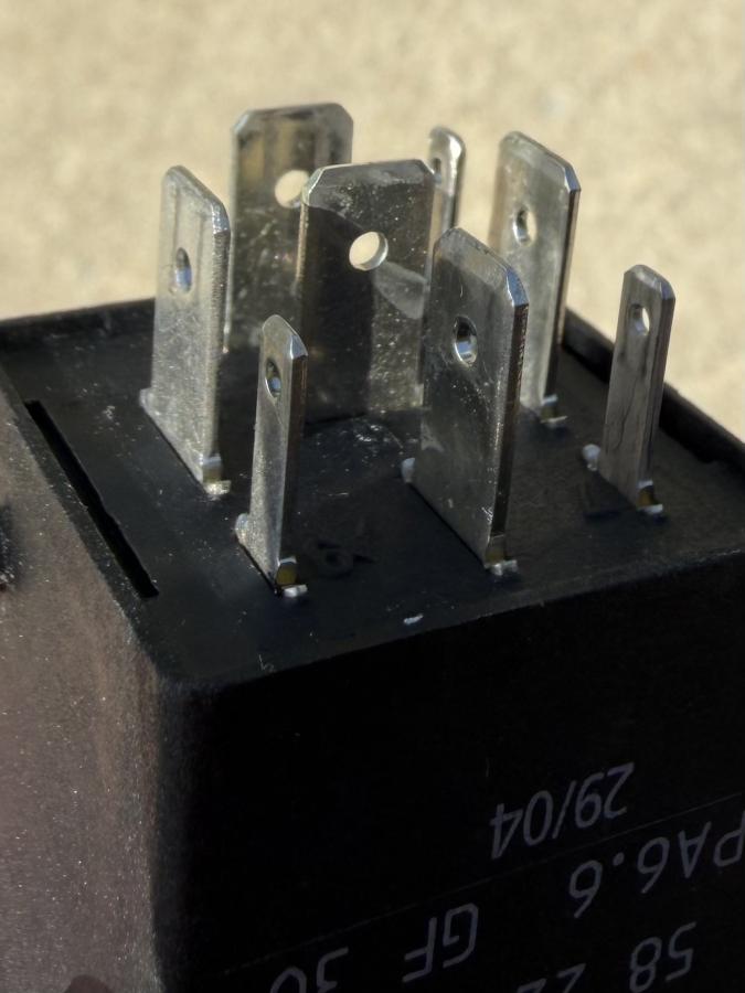

                                I kept both e-relays (EKP Modules) - I’ll clean them up. By the way - I assumed the discoloration on pin 8 was from heat based on the color.
                                terra the date on my “new” one I bought a couple weeks ago is 30/16. The one I bought three years ago has a 29/16 date. Your point on when they become NLA could be important.
