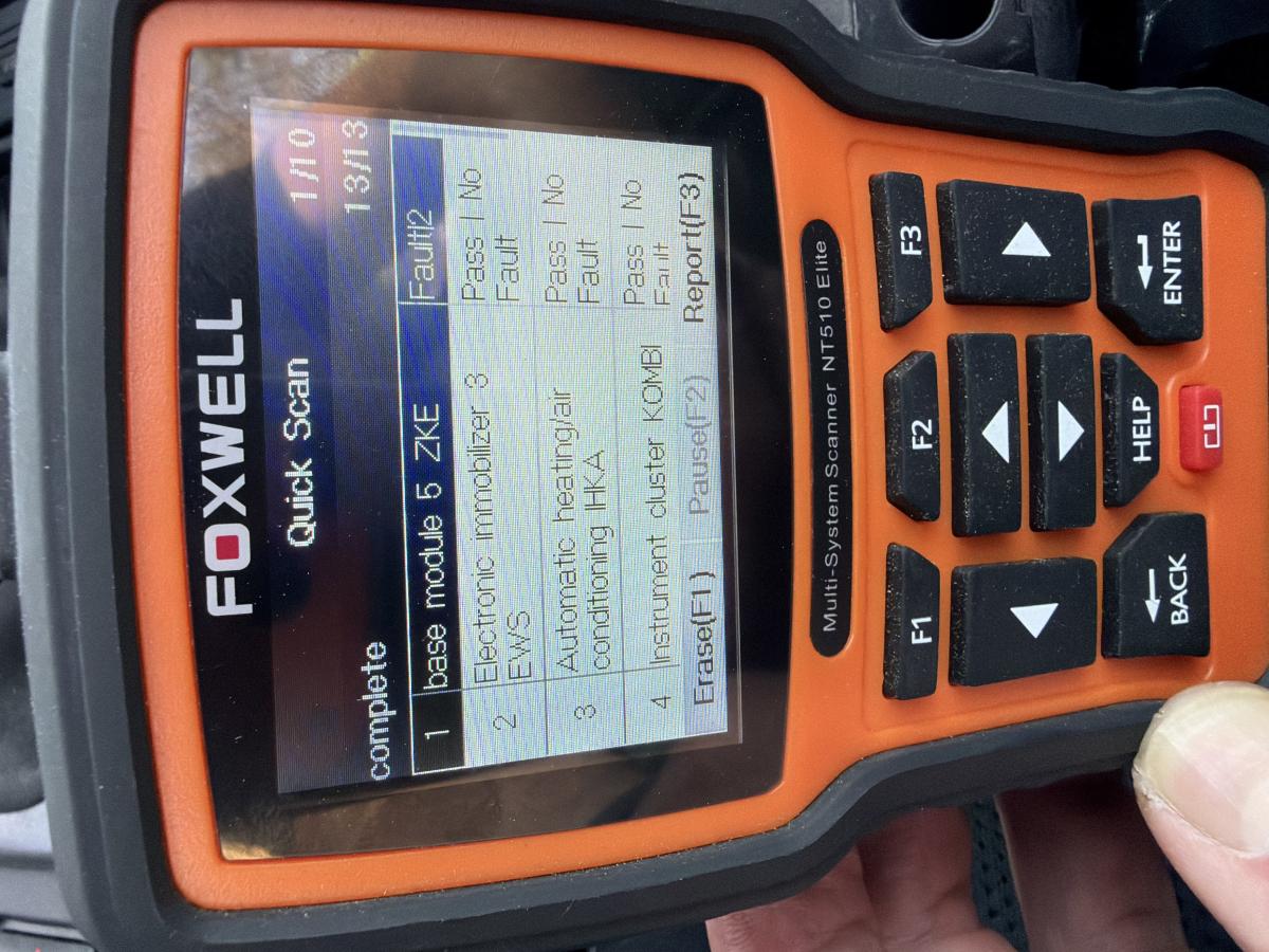

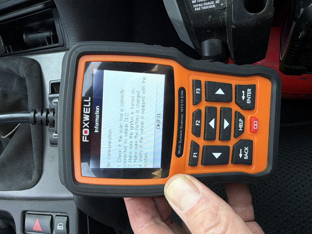

    Right after the failure, my Foxwell NT510 could still communicate with other modules, but could not communicate with the DME at all for about 30–45 minutes. Later the DME came back.

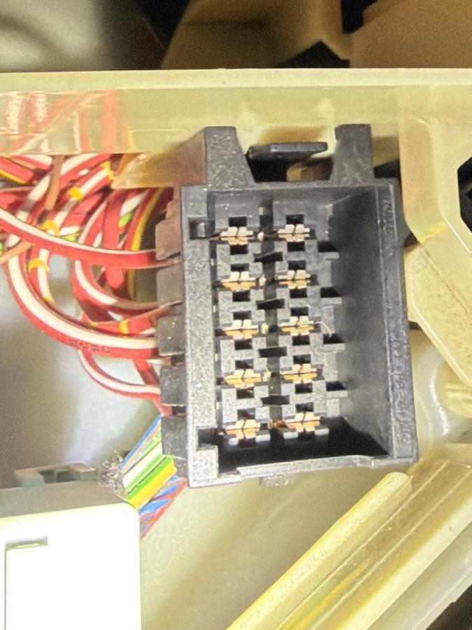

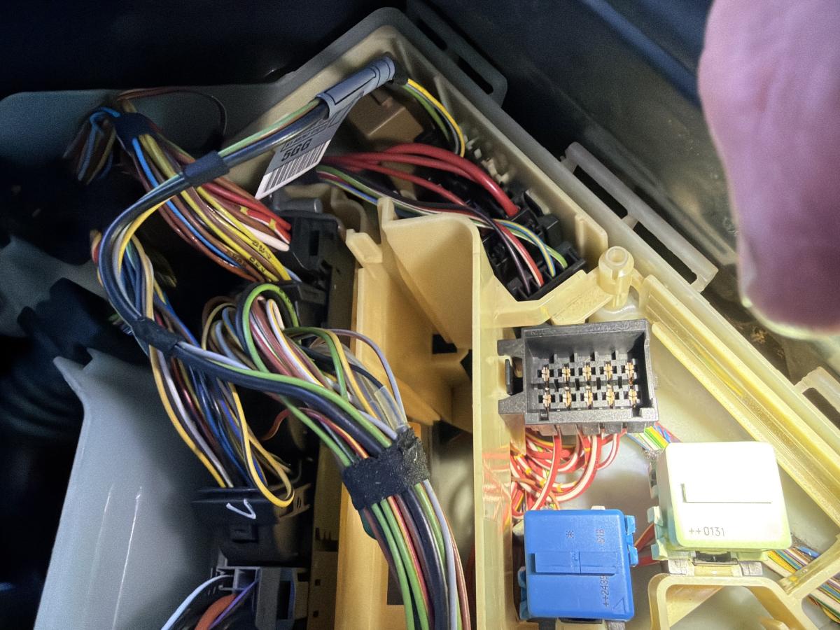

    - I’ve already replaced the blue DME relay and ignition switch speculating it was a DME power issue
    - E-box relay/fuse area does not show obvious heat damage or corrosion

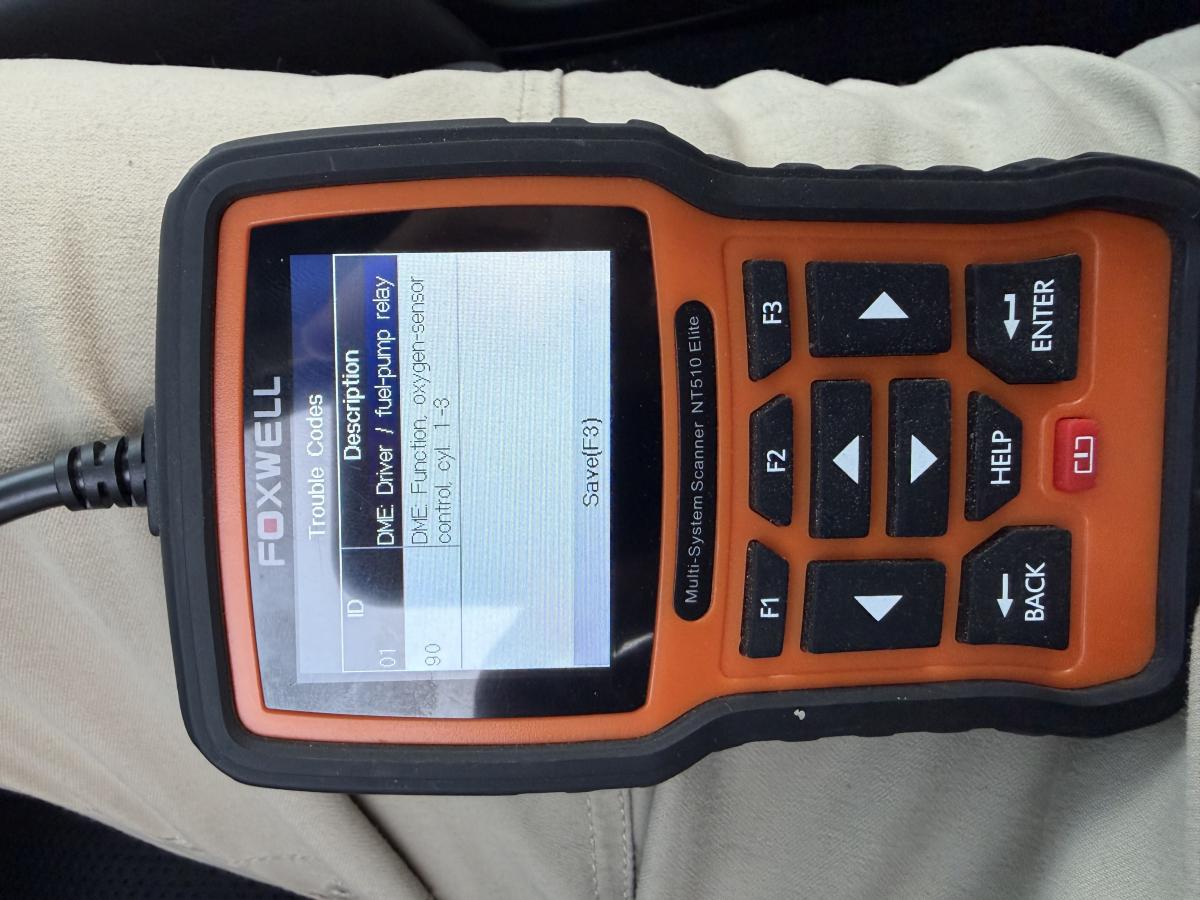

      Yes. On the first occasion, we had a DME 01 Fuel Pump Relay. Because of that, I swapped out the fuel pump relay with a spare that I had - as part of that other work I did between the first occurrence and the second.
      We had that same fuel pump relay code again on this second occurrence tonight and there was also a code 90 oxygen sensor control cyl 1-3.
      The car has that same fuel pump relay code before the dyno session two weeks ago. But I think that could be a trace of the DME dropping out based on my research
        This was odd. Right after the failure (<10 minutes)
        the Quick Scan worked, but didn’t see the DME.
        About 30 minutes later I could read the codes
