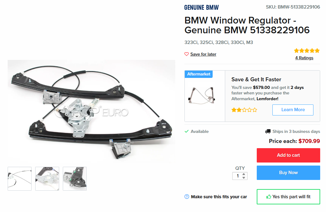

    Hello Group - the OEM window regular has jumped from 550 to 700 on FCP euro. With no quality aftermarket alternatives, I came across sapote comments about the common point of failure in the regulators. The repair kit Sapote mentioned is NLA on ebay (seller does not plan to restock either).
    I'm curious if any of the 3D printers or on the forums could help make the plastic piece (L) and possibly modify it mitigate the typical metallic crunch / ting sound that leads to most of us needing to replace the regulator.
    The weakest link of these parts is the steel bead B cut through the plastic window lifter L in pic below. I improved it by drilling couple small holes on both side of the cable near the bead and will small steel wire to tie the bead down tight to the lifter to avoid the bead cut through. Once it cut through hell broke loose.
    Good engineering should have made the bead interfaced directly to metal part, not plastic, and have the plastic inserts to ride on the regulator vertical metal rail for low noise and friction.
    Pic is from ebay seller for the repair kit $9. I would buy the kid to repair the broken stock regulator.
