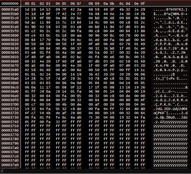

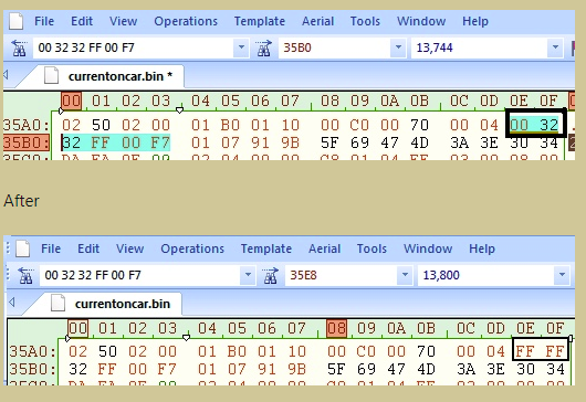

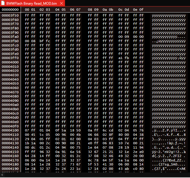

          sorry to resurrect an old thread, but just want to check with you guys before making any changes. the shop that did the conversion for the previous owner did not install the GPS 23142229113. the m3cutters link mentions modifying a couple sections of the .bin file which is no issue, but mine looks quite different.
          for instance, the first step is to modify 0x4028 and OP says it should be 01 changing to 02, but mine is ff. In fact, mine is ff from 3fc0 to 40f0 with only a couple bits being something else...
Name:	Screenshot 2023-08-29 4028 coded FF.png
          2nd part, it says to change 0x35ac from 0032 to ffff
          here is mine: showing 2e29
Name:	Screenshot 2023-08-29 35AC not 0032.png
          are these bits still okay to modify per the m3cutters instructions even though they are represented differently than what is mentioned?

            Those offsets mentioned are for a non-HP DME, and even then there are differences between versions.
            Use TunerPro, load the appropriate XDF for your binary version and then look for K_S_GANG_LL_ED and K_SKRAFTS_CONTROL and it'll give you the correct offsets to edit in your hex editor or directly inside TunerPro of course.
              #81
              really appreciate the advice, will take a look at TunerPro now
                here is mine: showing 2e29​
                I read it as 4B32, not 2E29.
                  #83
                  right, was referring to the m3cutters post where they mention 0032 which is in 0x35ae and 0x35af. i think there may be a mistake in the m3cutter instruction where they mention 0x35ac.
