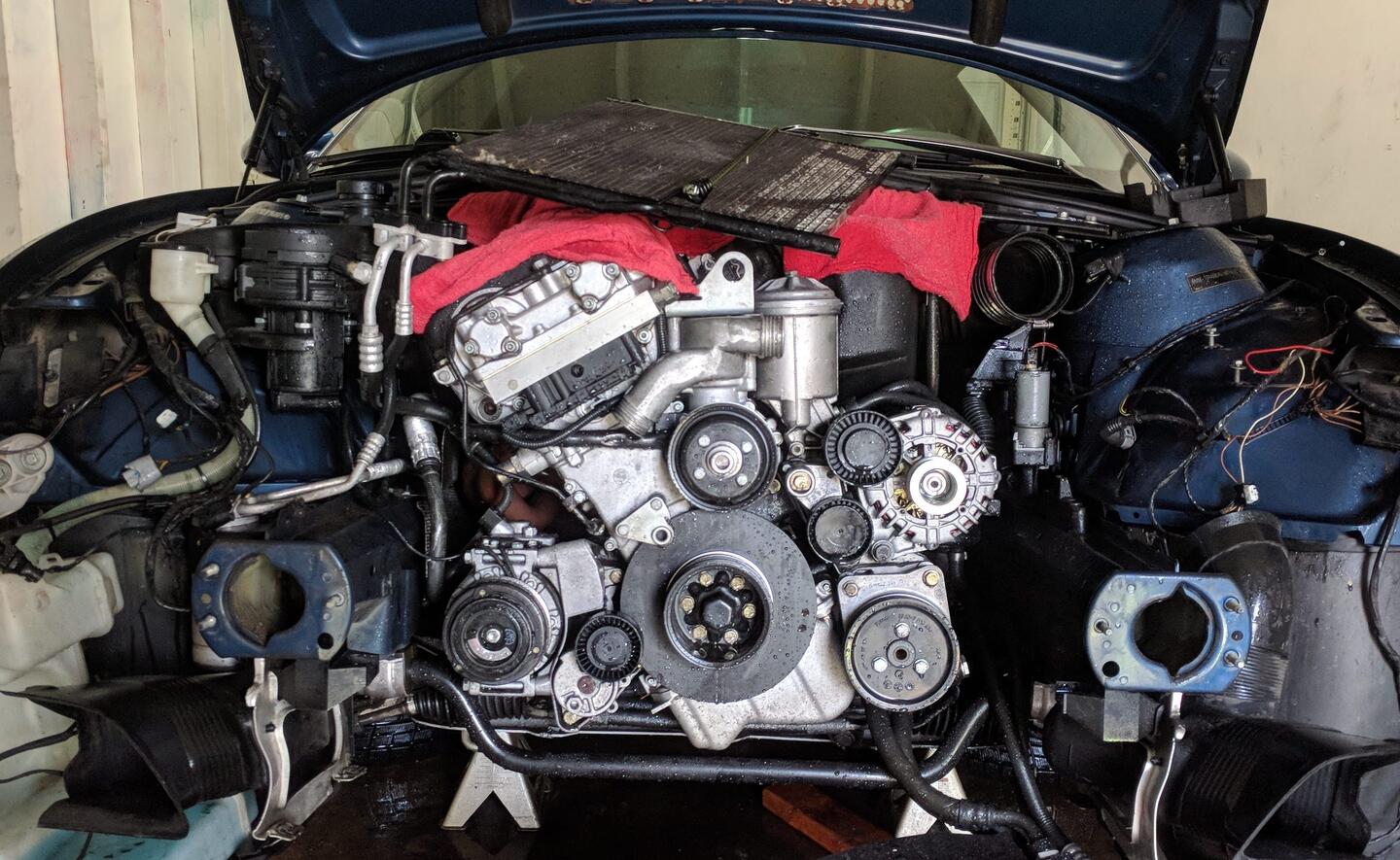

      I've pulled the front end off multiple times and have always just moved the condenser out of the way and rested it on top of the engine. The lines are not rigid all the way, so you can move the condenser around.

      You obviously won't be able to rest the condenser on the engine, but it's possible that you can move it out of the way enough so that you have room to do everything. At the end of the day, having the front end off is not a necessary step for removing the engine, but rather something that will make your life easier by giving you more space to work with, so having to work around the condenser is not going to stop you from pulling the engine.

            I just got back from the machine shop with my head. They didn't do any work yet but I just had them inspect it and all that. He took a look at the damage between the cylinders and said that he cant really tell if it will come out with .3mm. But he says there is a good chance it will. We did a ghetto on the spot "pressure test" on the valves and cyl 1 was leaking. Those valve seats will need to be re finished and if they are still not sealing properly I most likely have some sort of bent valve - but he doubts it.
            I showed him photos of the block and that nick in the wall. It *may* be able to be honed out. If not I will need to hope that my piston rings don't go up that high. I remember someone here said only the bottom ring needs to be underneath it -which it is - but he said if you want it done right you really want all rings to not hit that area.
            unfortunately, since budget is somewhat of an issue with this (college kid problems) I won't be honing out all cylinders because that would require new rings all around. He recommended that I buy a full set of new pistons but if I want I can get away with just 1 + 6 pistons. we can put them all on the scale and even them up as nicely as possible. Plus we can coat the piston walls with a moly like substance that will not only help lower friction but also help fill clearances.
            Only good news I got today is that theres a very good chance that the crank and bearings are perfectly fine.
            What im really trying to avoid here is a bore out job... at that point id rather just get a new block and call it a day.
            This all really comes down to 1 thing... can the small nick in the block be negated. If so, id need a rehone on 1 cyl, head resurface, valve seats grinded, block sanding, 2 pistons + rings. And obviously the head gasket.
            Plan of action here is to get the block done first. If thats unrepairable ill cut the whole plan off there and buy a new block.

                  Just buy one piston and rings. Get the block decked. Light hone of the bore, skim the head and chuck it back together. That will get it going again. Then start saving for a replacement!

                    Looks identical to my S54 when I blew the gasket between 5 + 6.
                    I ended up buying a blown motor and using the head, block, and pistons off that blown one since it spun a bearing.
