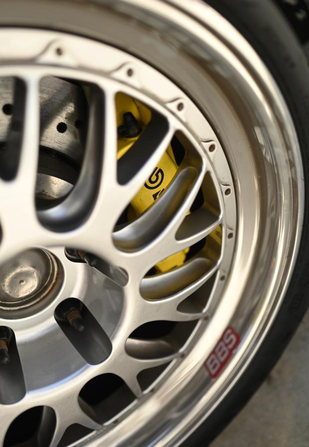

            Here's how mine look
Name:	2026-04-15 11.10.12.jpg
            They hit the rim of the wheel not the spokes

              Hmm thanks for adding a pic cause I still was having trouble envisioning this. So it's more an issue with the 3 piece wheel construction/combination than normal metrics like wheel size and offset alone.
              And your caliper, even if it's not abnormally large, because it sits farther outboard from hub due to larger rotor, does come into contact with whwre the wheel face meets the rim which is even tighter it looks like.
              A true 19" e88 would probably clear then right? Things are tight because it's an 18" face adapted to 19" barrel?

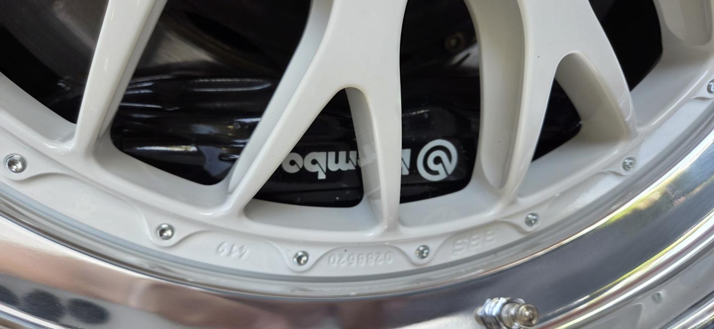

                            I looked up a image of E46 M3 specific Brembo GT 355 kits.
                            Click image for larger version  Name:	dsc05881-jpg.273484.jpg Views:	5 Size:	200.2 KB ID:	354022
                            While DINAN 19s were designed to clear 380s without spacers, many other wheels were not.
                            Edit: OP posted that the kit is 355mm
