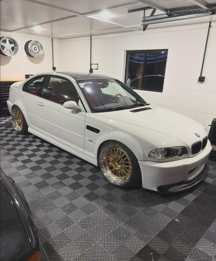

            These are the wheels I purchased, and these are them allegedly on his car.
            Authorized BBS Retailer- all BBS products are genuine. Description: Brand new, custom built, Ehrlich Spec BBS E88 race pockets in BMW fitment! These will fit E46 M3 + E9X M3 with BBK clearance. They are built with genuine BBS rim halves and hardware.  These wheels are for off-road use only. Specifications: Front: 19x10
            IDK, there was still some funny business going on.
            I purchased the wheels over the weekend. When I purchased them, I put in the notes I wanted them white, as he was running a promo to have them any color I want for free.
            Well early Monday morning, like 7AM pst, I hit him up on Facebook and told him I think I wanted to keep them gold. He told me the faces had already been stripped for powdercoating, and that there was some "chips in them" anyway. ?? IDK why he was selling wheels with chips in them... especially for "new" prices. But for some reason they were able to strip the wheels in under a day, but then it took another 8 weeks to actually finish them.
            I could never prove it, but I don't think the wheels I received were the same ones in that pic.
            At the end of the day it doesn't really matter.
            The 620 faces don't fit over my brakes.

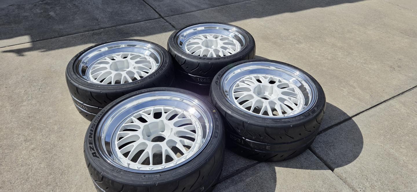

              Have photos of your wheels?
                #37
Name:	2026-04-15 10.39.46.jpg

                  FWIW, I know they chemically stripped the wheels when I had some LM 089's rebuilt, so that part doesn't take much time.
                    #39
                    Hey man, I am really sorry you’re going through this. I know it definitely sucks. I piece of advice, contact BBS USA. Ask to speak with the Motorsport division as they generally handle e88 wheels vs the road wheels. Give them the center numbers and they can email you an excel spreadsheet with every single build spec using the different lips and barrel sizes with the resulting offset.
                    Also, ask them what spacer is needed for the center to clear the BBK. From there you can see the possibilities.
                    Those look like 2” or 3” lips. You may have to order a set of new lips and barrels to get the proper offset to run that spacer that you need. You may end up with like a 1” lip and a bigger barrel to run that square setup that you want. May not be what you wanted but maybe it can salvage the project if Paul is willing to not take them back without restocking.
                    Also I wouldn’t ship them back to Paul to have them rebuild them. You can probably do that yourself as e88’s are made to be easy to disassemble and reassemble.
                    Finally, in the future if your planning on buying BBS wheels either used or new, ALWAYS, ALWAYS, ALWAYS call BBS USA first an explain what your trying to do. Give them all the details: what car, brake system, specific wheels, and tire size and they can give you results. They have thousands of templates and CAD models to ensure proper fitment. BBS’s customer service is honestly second to none and has made me a BBS customer for life.

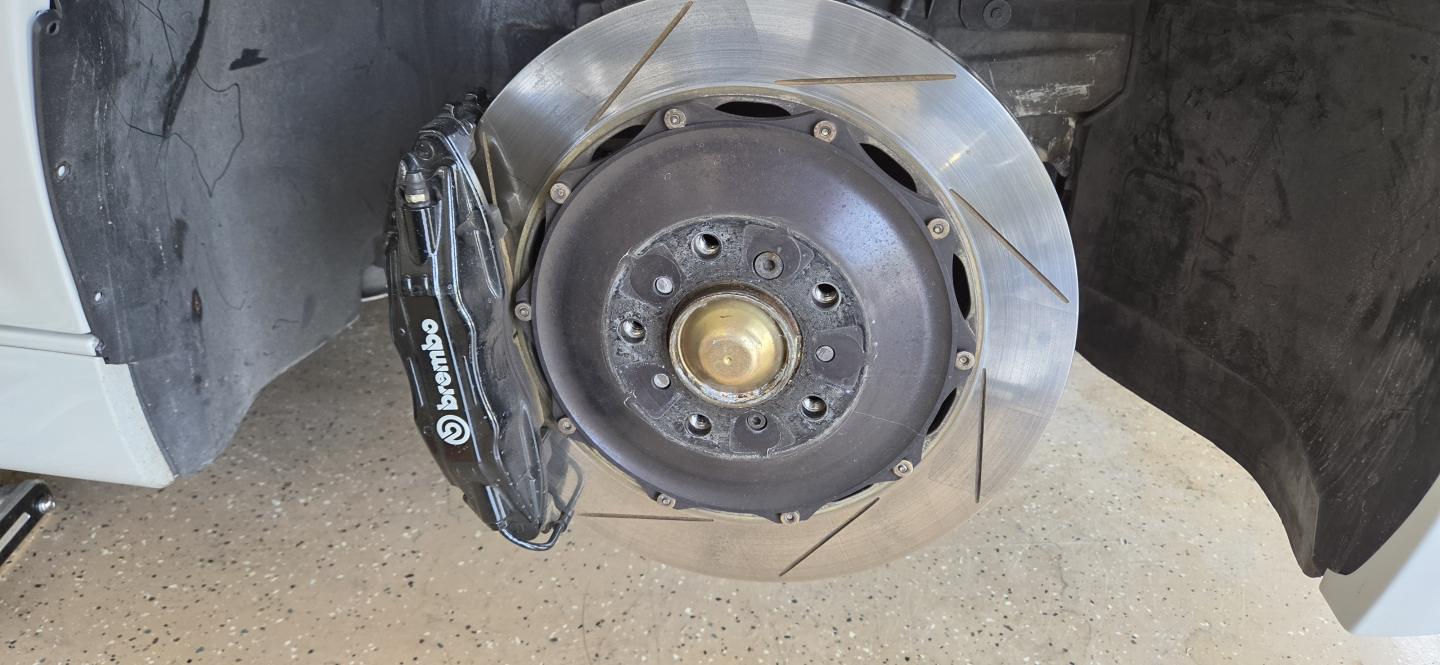

                            Sorry you have to go thru all this nonsense. Just out of curiosity what Brembo kit are you running? I had to use utilize 18mm front wheel spacers to fit ZCP wheels to accommodate Brembo GT 380mm with 4-piston calipers.
                              #44
                              This is the older Dinan kit with the F50 calipers.
                              I'm researching newer calipers and seeing if they will fit with smaller spacers.
Name:	2026-04-15 11.14.07.jpg

                                Geez...that is as standard as standard could come. Any progress? Let me know, I can go scorched earth on this dude. He'll be like...who da fuk is dis? lol
