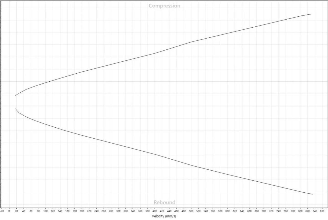

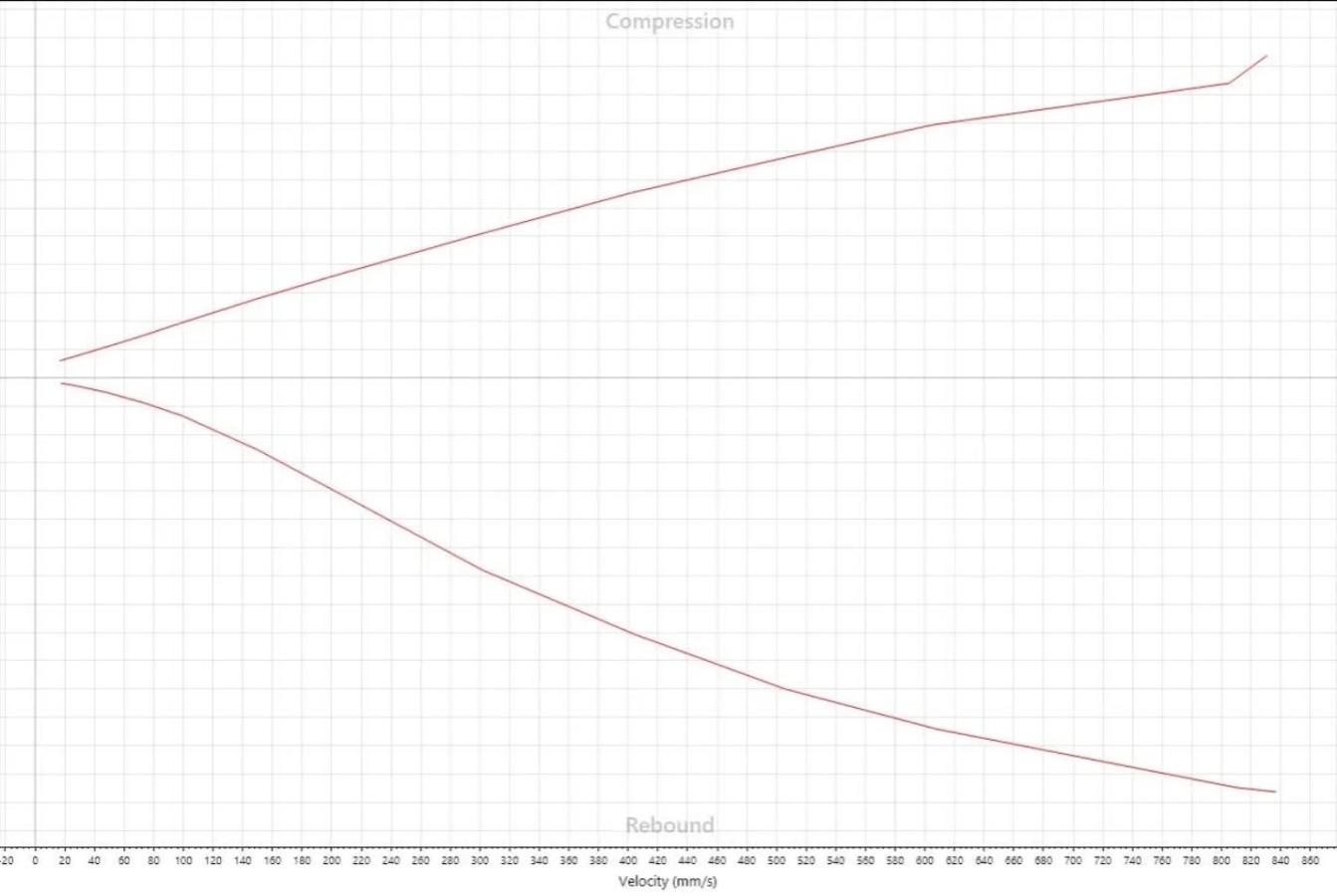

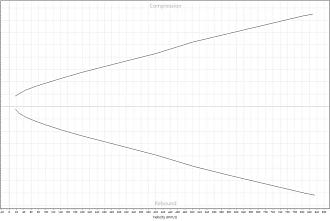

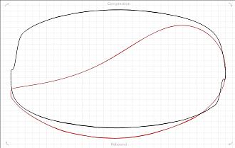

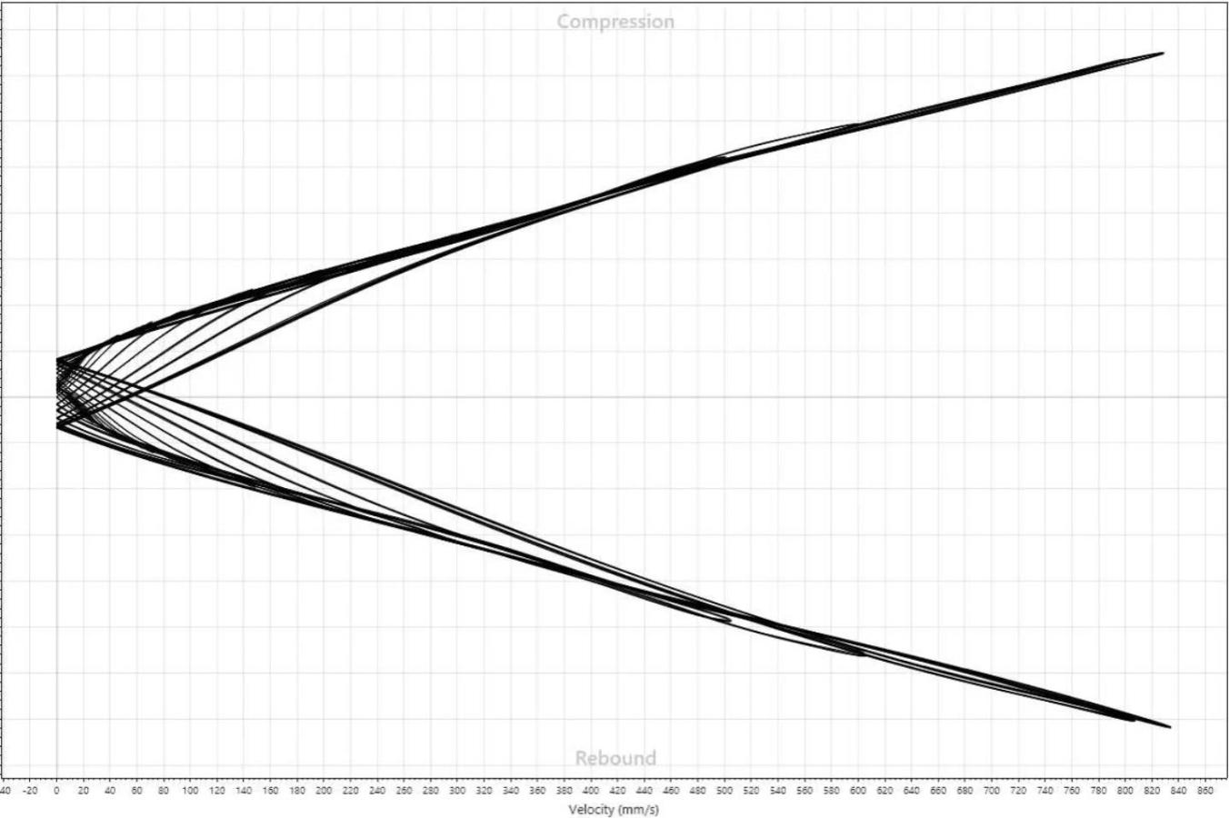

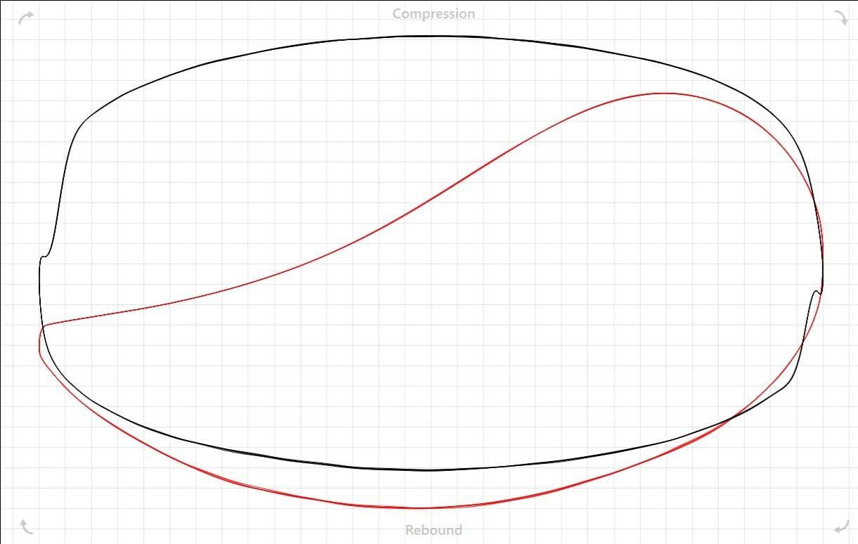

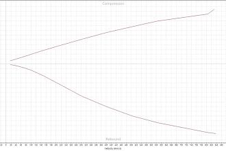

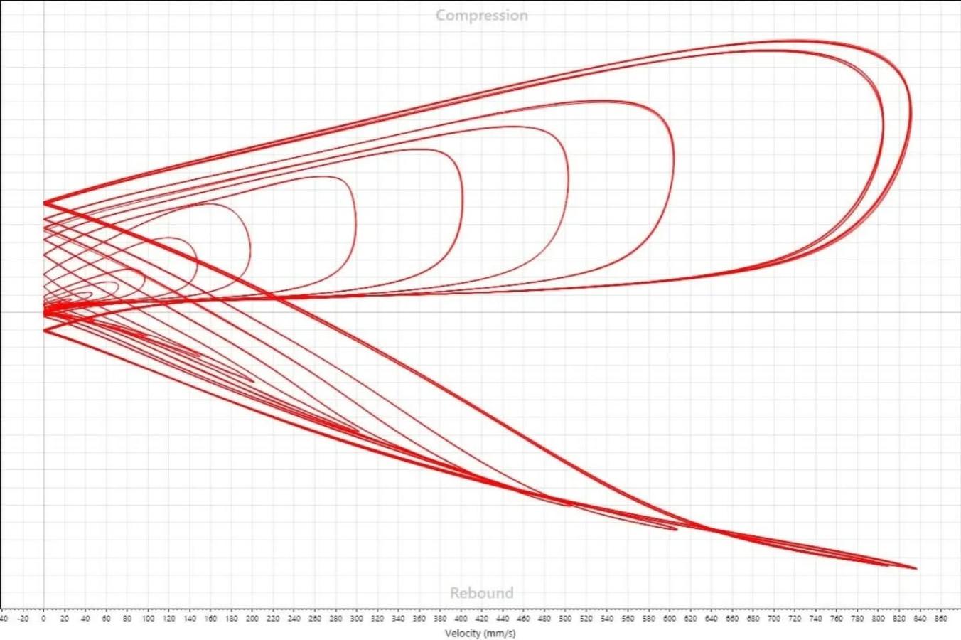

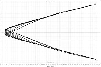

                            Putting them on a shock dyno does nothing if you don't dictate what kind of measurement you did. PVP? CVP?
                            Anyways, here's ACTUAL CVP shock dynos of KW V4's vs Ohlins Road and Track. Ohlins in black, KW V4's in red.

                              To be honest, neither dynos look great.
