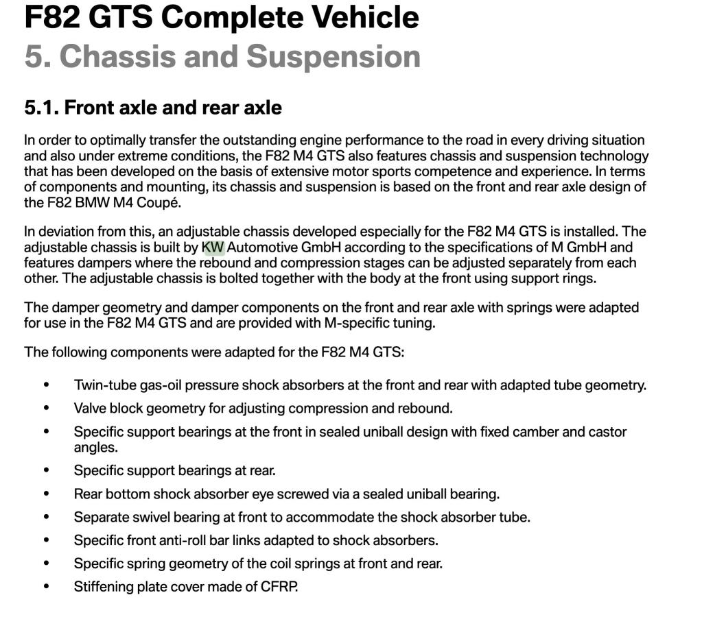

                              Fun fact, both M3 and M4 GTS were equipped with KW suspension.
