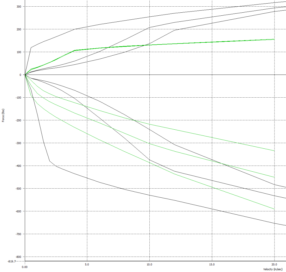

          Just looking at the V3 Front...
          It has a large adjustment range with a digressive valve stack on both compression and rebound.

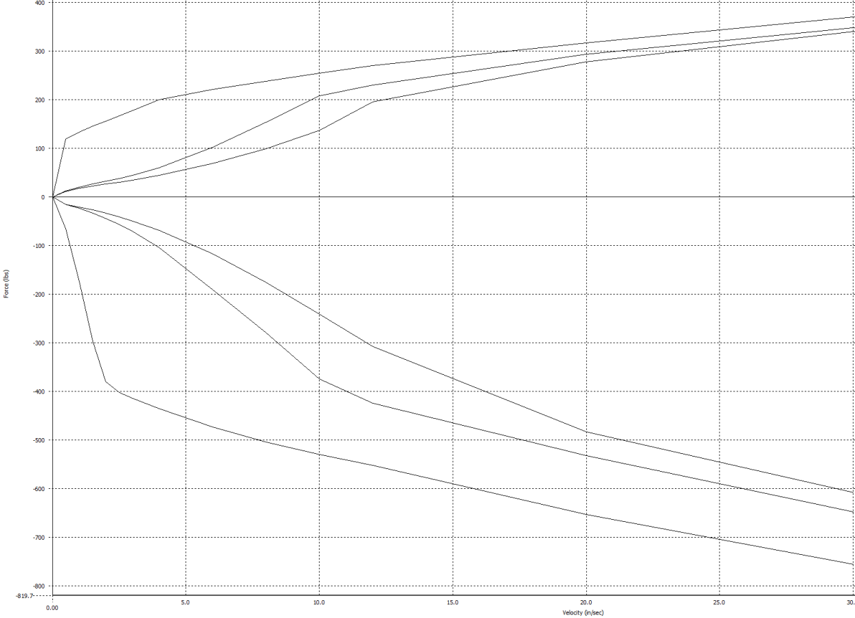

          Looking at just the "middle" setting. There is some hysteresis as is typical with a shock with such a wide adjustment range. But certainly nothing out of the ordinary like that V4 dyno curve above.

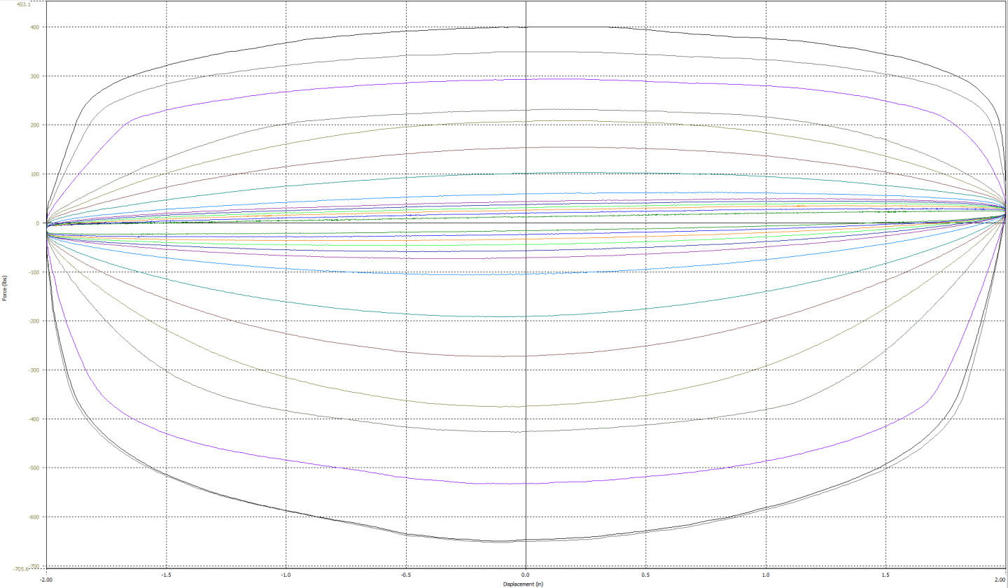

          By comparison, a Koni Sport (yellow) makes far less compression damping than the KW and only has rebound adjustment. To me this explains why it blows through the travel so easily but also feels comfortable on a smoother road or during casual driving.
