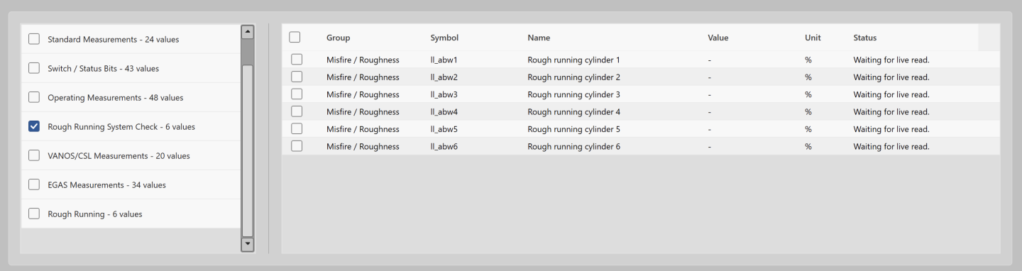

      Is it worth including injector testing from DIS?
        It's already there :-) Data can be interpreted in the same was as you would in DIS/INPA/ISTA

          Is there a guide on how to interpret the data? Been thinking of getting my injectors cleaned for a while now.

            I had forgotten about the rough running data.
            There is also an injector activation section in DIS where you can activate individual injectors. I'm not sure how useful this though. Since all you could do would be to listen for the clicking of the injectors solenoid.
            Would there be any other use for the injector activation part of DIS?
                Essentially non-zero values are compensations to the injection amount (as a result of the injectors not all behaving equally). The caution I'd give is I *think* that if you happened to have a vacuum leak that affected one or more TBs it could also result in compensation, even though the injector isn't the root cause. So I think this can be useful, but is not an entirely causative diagnostic test.
