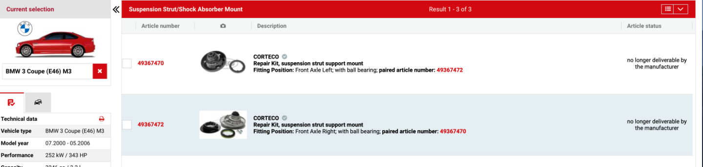

      While not ideal... used looks like only other option besides the other 3.
      1. Waiting on BMW backorder
      2. Finding NOS BMW or Corteco (49367470, corteco part # for drivers side)
      3. Going down Aftermarket route
      Corteco might not be an option...
Name:	Screenshot 2026-05-15 at 6.52.15 PM.png
