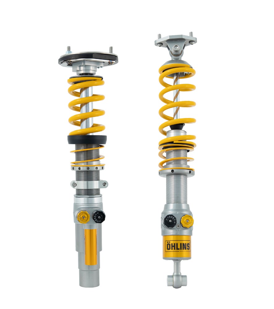

            Upgrade your Bmw M3 2001 (E46) with Öhlins Advanced Track Day Shock absorber kit for maximum control, high-speed stability, and consistent performance under demanding track conditions.
