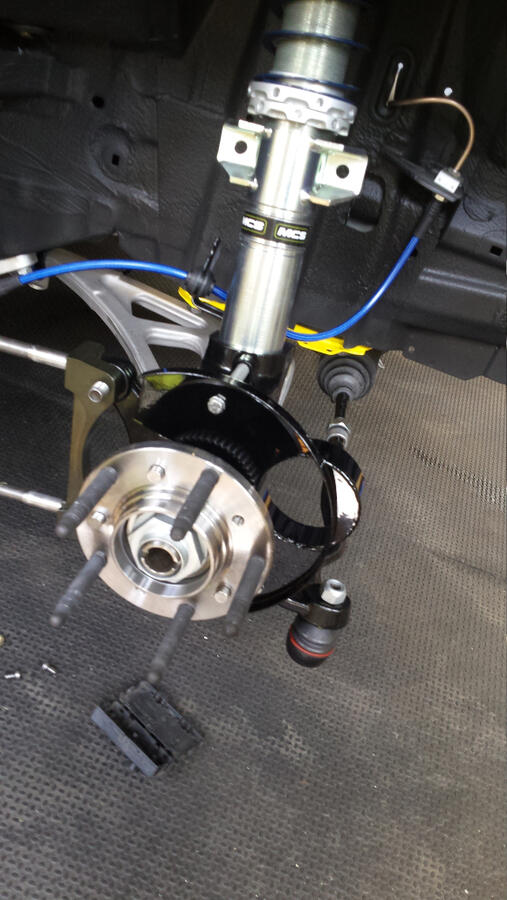

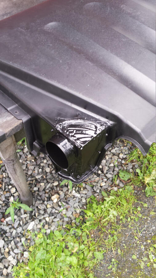

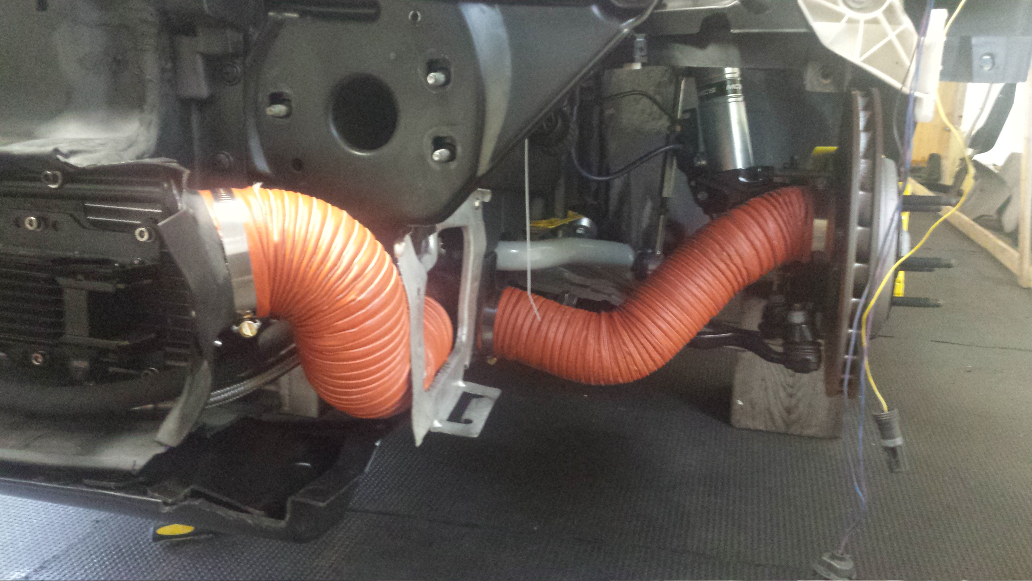

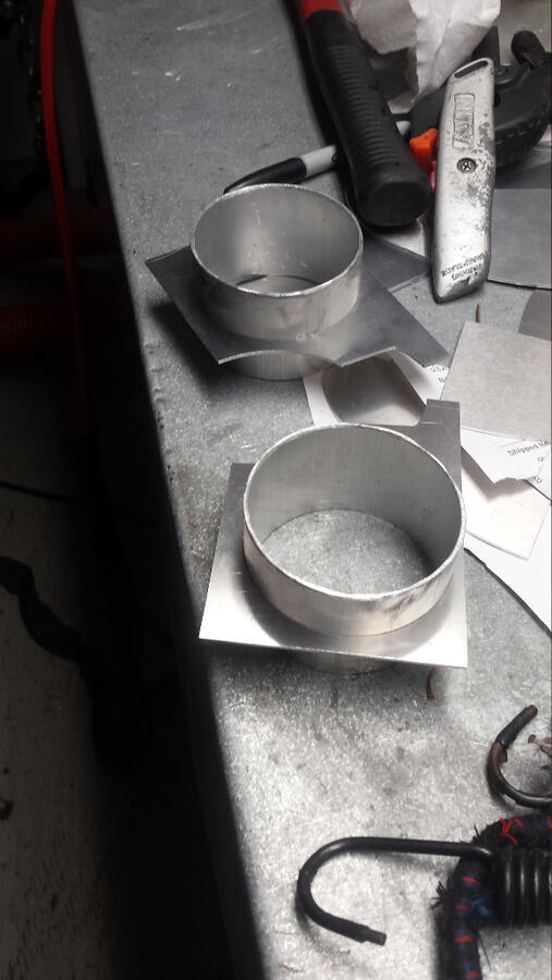

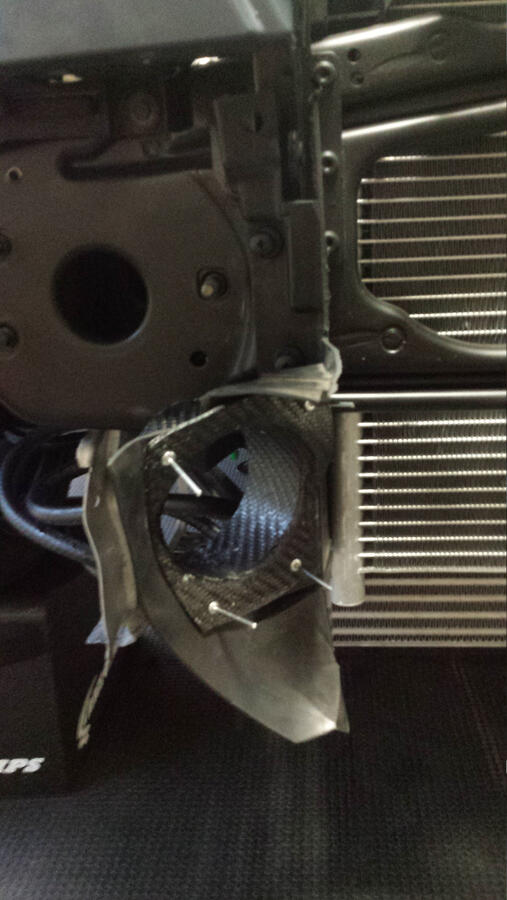

            I ran into the same problem when adding a CSL bumper. Decided to make some carbon bits which rivet into the stock air guide.
