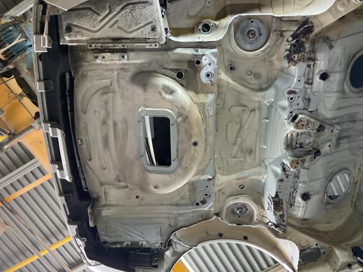

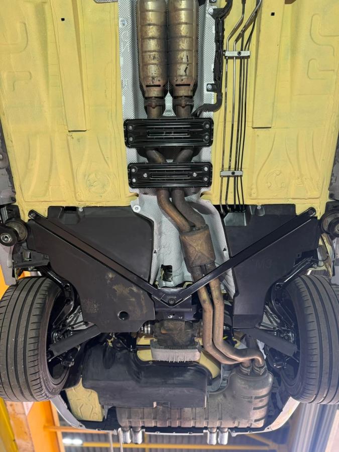

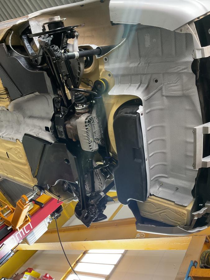

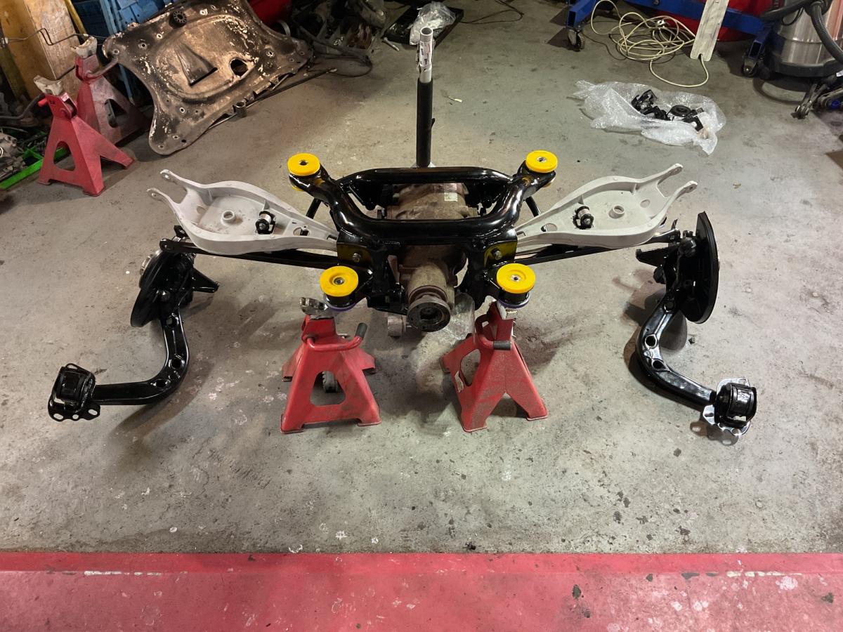

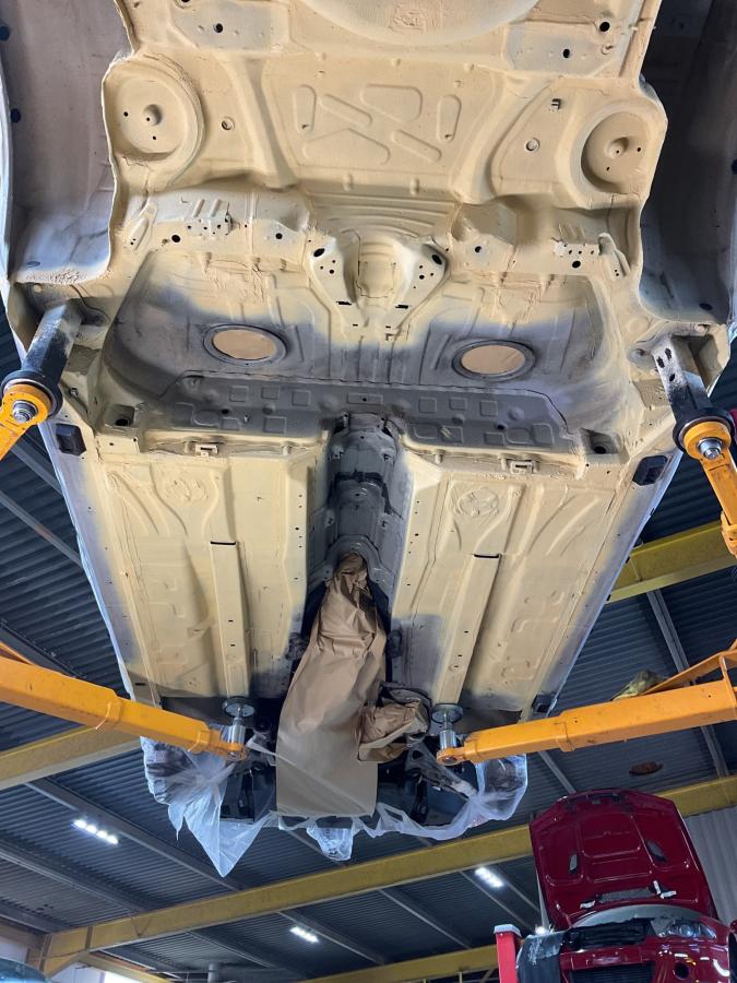

    I figured fellow E46 fans may enjoy this. This work was carried out over winter.
    With the car off the road for the year, I took it to JWS Motorworks for them to install a Redish RACP plate kit & supplied them with new replacements of anything they'd be taking off to carry out the job, and a few other bits - job quickly turned into an underside restoration from the mid of the car backwards - albeit with the effort going towards functional replacements & rust/future proofing, rather than a full blown anal nut & bolt approach.

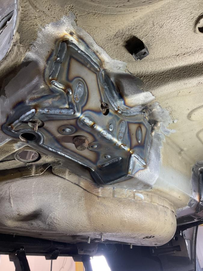

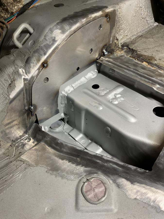

    The work carried out included:

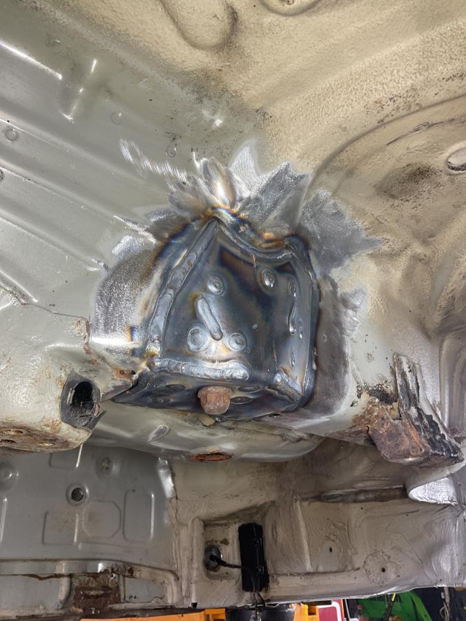

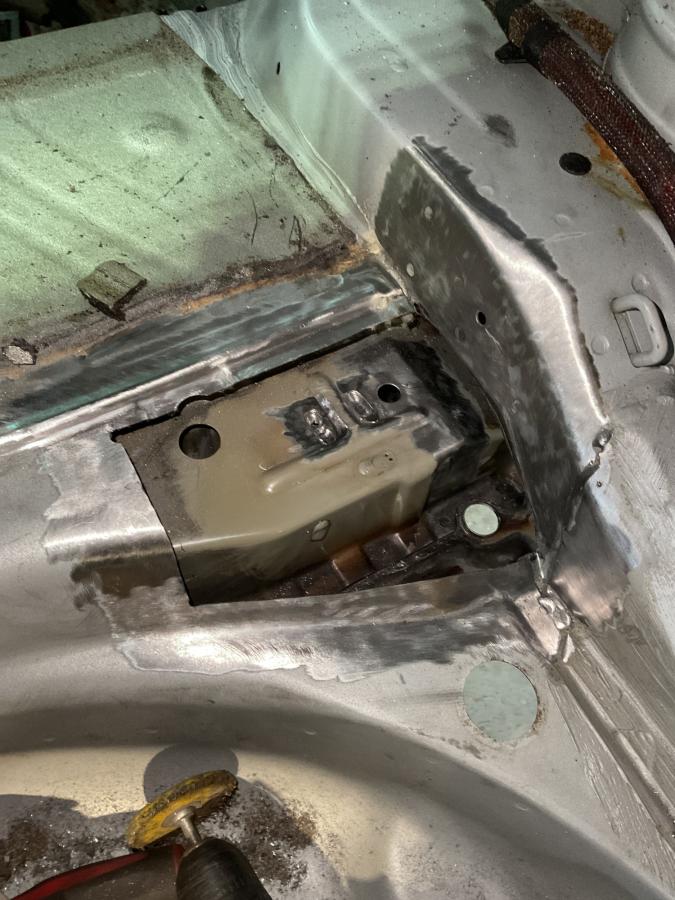

    • RACP reinforcement using the Redish plate kit on the underside and interior bracing.

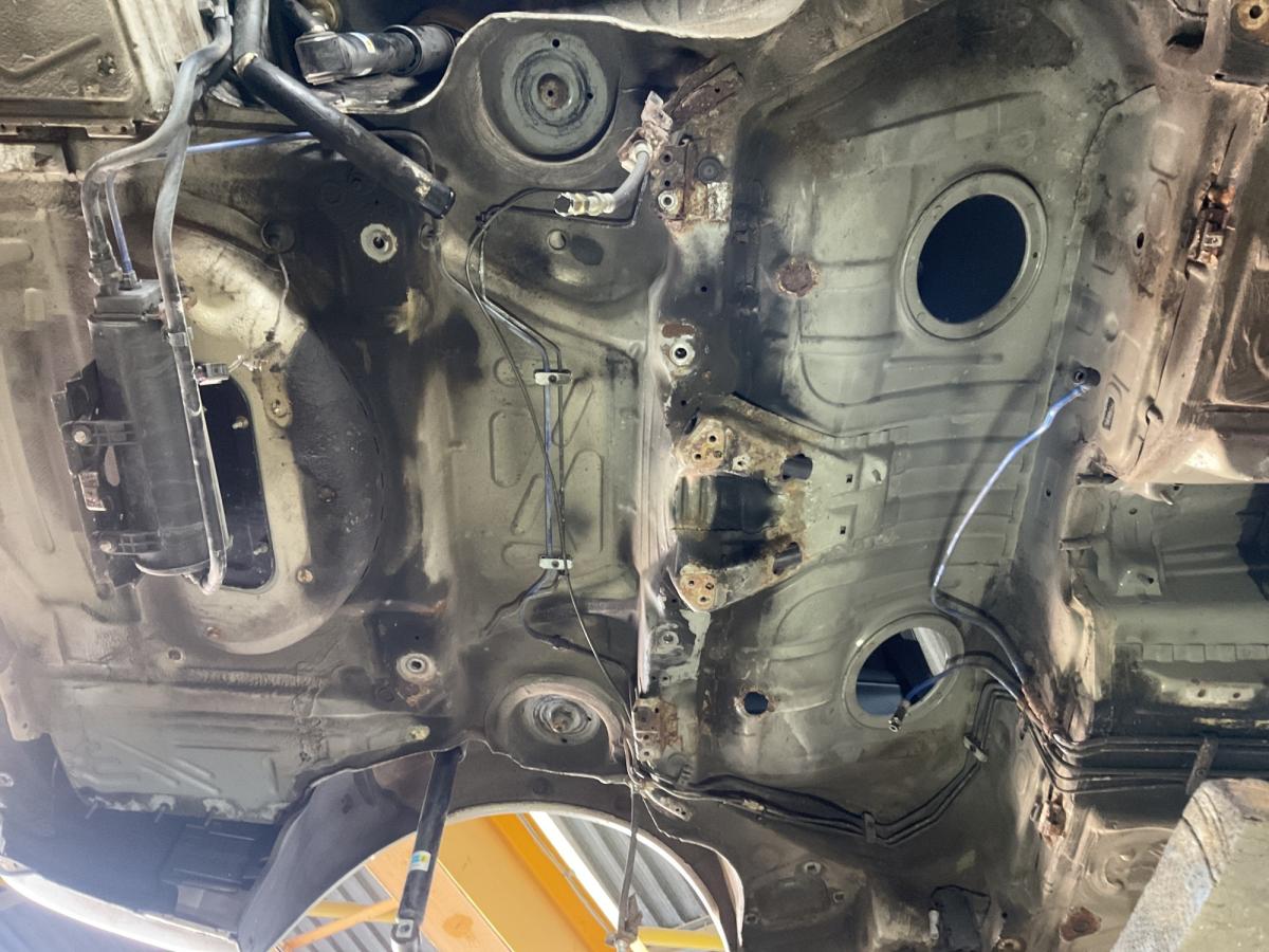

    • Clean up, removal and treatment of any existing corrosion
    • Removal of the factory floorpan grommets & battery bracket (known starting point for corrosion)
    • Continuously welding the factory spot welded lower arch seam
    • New rear springs (existing ones were flaking)
    • Exhaust hangers, brackets, mounting plates, gaskets & hardware replaced
    • A pair of new driveshafts

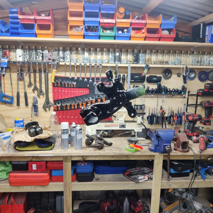

    • Subframe, brace, knuckles, arms and all other major components blasted and powdercoated

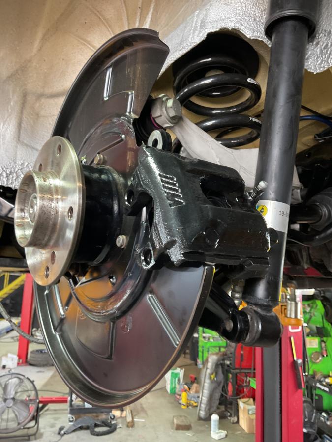

    • New bushes (Lemforder for the control arms, RTABs, droplinks etc, Powerflex for the subframe & ARB).
    • Rear calipers painted & new flexis
    • New genuine steel brake lines front to rear
    • Wheel bearings, handbrake assembly & backing plates replaced
    • All brackets, nuts, bolts, hardware etc replaced with new
    • Underside painted/seam sealed & undersealed
    • Alignment & MOT
    Essentially an underside restoration, albeit with the diff left for later on.
    I had already rebuilt the prob, CSB, gearbox mounts etc prior to this.
    Note the final finish isn't half as yellow as the photos make out.

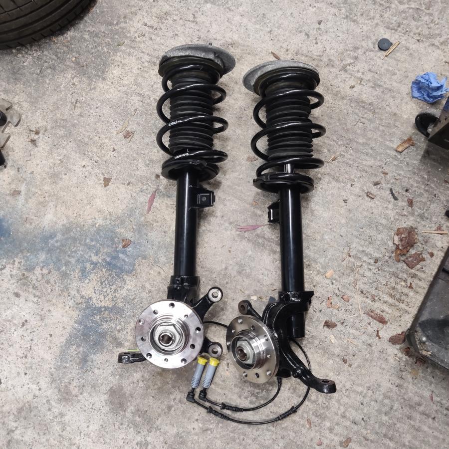

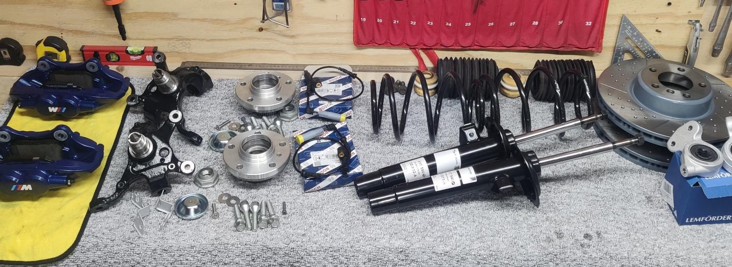

    Then I got around to sorting the front end out. Cleaning the knuckles up, new struts, springs, wheel bearings & an F30 BBK:
    Click image for larger version  Name:	IMG_20251111_175905.jpg Views:	0 Size:	170.2 KB ID:	356038
    Click image for larger version  Name:	IMG_20260223_152303.jpg Views:	0 Size:	170.5 KB ID:	356042

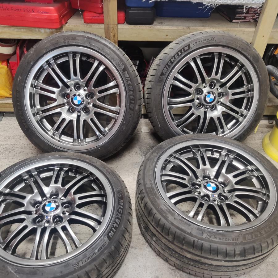

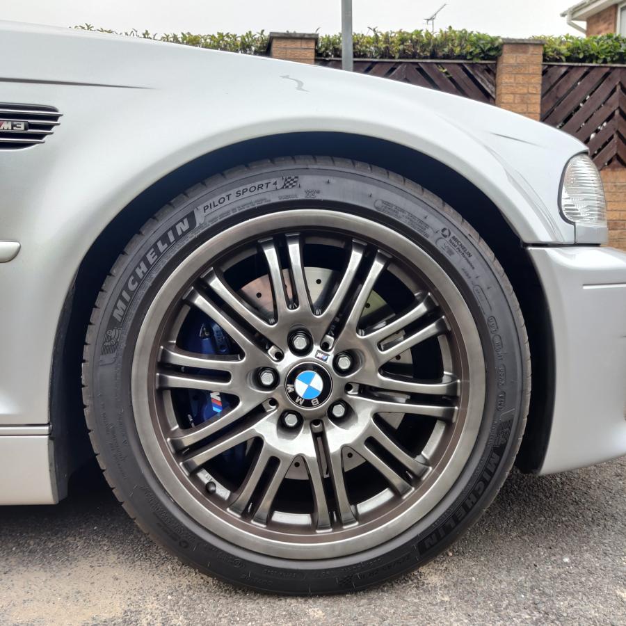

    Then a wheel refurb:
    Click image for larger version  Name:	IMG_20260305_141752.jpg Views:	0 Size:	160.3 KB ID:	356044
    And the car was back on the road...

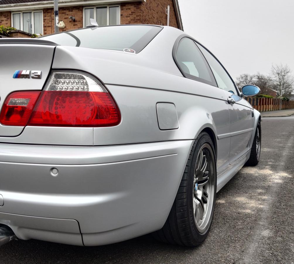

    Click image for larger version  Name:	IMG_20260320_115737.jpg Views:	0 Size:	151.2 KB ID:	356040
    Click image for larger version  Name:	IMG_20260320_115751.jpg Views:	0 Size:	134.3 KB ID:	356039
    Click image for larger version  Name:	IMG_20260320_115808.jpg Views:	0 Size:	123.6 KB ID:	356043
    Click image for larger version  Name:	IMG_20260320_115759.jpg Views:	48 Size:	117.6 KB ID:	356041

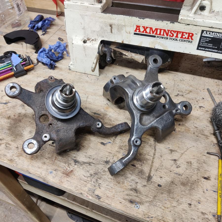

    Very nice! Where did you source the front L.H spindle? I can't find these, only CSL spindles seem to be available.
      They are original to the car, just needle scaled & painted.
