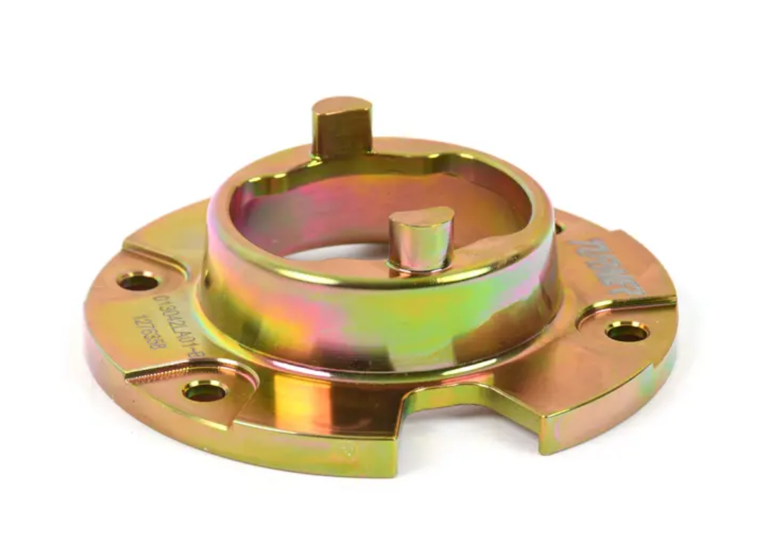

    The longer supplied 4 bolts is to ensure all 6 bolts have the same factory thread depth. The adapter only load is to rotate the pump disk, and has zero load of rotating the cam. I don't see these bolts are in any potential damage more than the stock setup.
    The 2 driving tabs are on a relative thick base and so it seems to be a good design, but I can't tell if the material is strong or not.

        Do we know if this adapter has larger driving tabs for minimum plays in the stock pump disk holes?

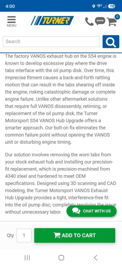

          Yeah it definitely does, but the very last sentence of the product description almost made me laugh out loud.
