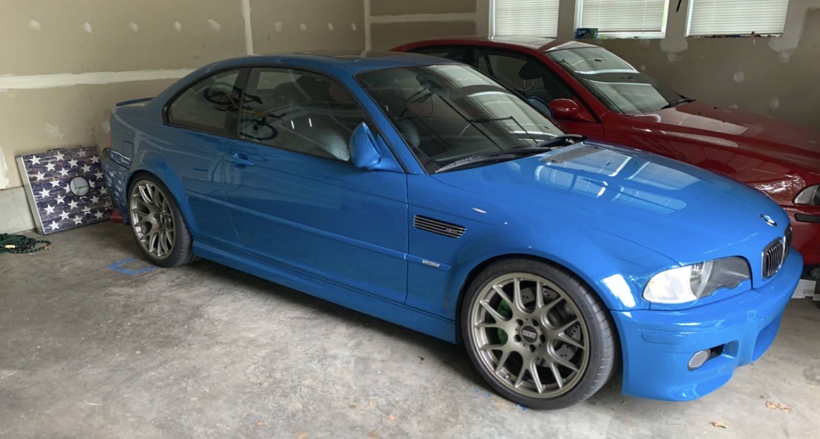

                              this is the before, when it was low. I’ll update with current height later tonight.
