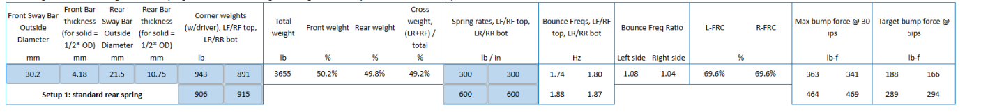

                      I researched this topic for many months, too many months, before pulling the trigger, and my criteria then sounded very similar to yours - if i were to distill each of my finalists/strategies into distinct go-fwd plans they'd be as follows and i'll explain what i went with and why:
                      1. rebuild the car with 100% stock components
                        • i, along with many, have never experienced the car in its original early-aught form with fresh rubber bits and all the other fixins
                        • It's safe to assume that motorsport engineers got it fairly right out of the box, though the arguments to the contrary (i.e. constraints to deliver to a mass-market vehicle) were compelling enough for me to evaluate other options, paired with the robust aftermarket for these cars 20y later
                      2. true OEM+ build. I understand this is a highly-subjective, even controversial if not annoying, over-utilized term
                        • To me, OEM+ a car in this context means nearly 100% stock components and aftermarket for a few tiny select components, for example: hollow adjustable front sway, monoball RTABs, and solid subframe bushings
                        • I was so close to doing this. shoutout to Chas3n - whose notes and anecdotes were instrumental in my research, there were others too but i specifically remember his
                      3. Non-coilover, but aftermarket shocks/springs
                        • like Koni shocks and Eibach springs
                        • what killed this one for me is that i wanted to set it up once and be done with it and just enjoy driving it - the idea of this solution - inevitably hitting limitations (i.e easy adjustability in each corner) and possibility of wanting to change setups a few years from now was not ideal
                        • I know many on here swap out setups like changing a shirt - i decided to "future-proof" the build as much as i could - which meant, keeping the setup nimble enough to tweak things down the road
                      4. Reputable, well known aftermarket setup - but OEM setup/spirit
                        • I chose from Bilstein PSS10, TCK and Ohlins ---- went with TCK SA
                        • Could have easily gone either way here - but decided against Ohlins because flamesuit-on - these cars tend to look at a little low, maybe too firm, for my desires (not in a bad way, i realize i am Unc now; still leaving flamesuit on)
                        • Decided against Bilstein, this is dumb but i hate the way they look like they've been sitting right outside chernobyl after a few years. And got spooked reading some anecdotes about transatlantic warranty and support ops, not sure if that's real honestly
                        • TCK, given it's koni-based system (aka softer side) made the most sense. they're US-based, you can call them and they pick up right away, and they've been doing it for decades. The other day i watched a BMW Classic video on YT, and was pleased to see one BMW NA's race cars fitted with a TCK system. If it's good enough for BMW NA, it sure is good enough for me -- lol just not bone stock i guess
                        • i didn't even know if or why i needed DA, which answered my question (re: do i get SA or DA)
                        • i went against TCK's "recommended" spring setup on their site (which i think is 500F/400R) --- and went with 300F and 600R for a more OEM-ish (dare i say flat-ride) setup
                        • unintentionally backdoored my way into a PSS10-esque setup anyway in terms of spring rates, of course TCK is linear unlike the billys, but nonetheless
                        • i added:
                          • front sway from BW (hotchkiss supply issues at the time)
                          • Solid sub-frame bushings from BW
                          • monoball RTABs from SPL
                          • ARCA from SPL (prob overkill for my needs honestly, the subframe bushings aren't "raising" ones which i blv require ARCA, but it unlocks for play with diff setups in the future if i get bored, keeps spirit of adjustability etc.)
                          • Adjustable front-end links from Turner (to dial-out preload)
                          • Genuine everything else: front hubs, rear bearing, driveshaft bits, guibo, any bushing not listed, rebuilt rear axle shafts, you name it, it got done. everything but full diff rebuild, which was a mistake in hindsight
                          • unrelated, but took care of the RACP too (CMP bottom + top stuff). sidebar - first car tech had seen ever, and he worked on them new for BMW, with nary a fracture. not even a hairline anything. oh well did it anyway.
                        • car sits at stock ride height currently, which looks a teeny tiny bit lower with the TCKs? hard to tell honestly
                          • it was initially (id say a lot) lower, i raised it up during corner balancing and final dial-in which was about 300 miles after install. it was rubbing like a mfer on abhorrent-Raleigh NC (city-limits) pavement. looked sick though
                          • i have urges sometimes to drop it ever so slightly, might do this later this year but tbh it's fine
                      Notes
                      • I had trouble finding even 1 bad review on TCK across 20 years of foruming, even across platforms (studied not just E46) (even went to wayback machine and started mining M3F where i could, thankfully many of the greats are here though - Obioban's suspension thread was super clutch. i reviewed it word for word more times than i want to admit). jvit27 - who has tried virtually every different setup has a great post out there in the archives talking through his experiences w/ each that i found illuminating too. although given you already have ohlins, realizing that some of this might be redundant for you
                        • attached some specs from the famous flat-ride spreadsheet from FCM, i also have my alignment/corner balancing results too if you're interested in checking that out
                        • i was a little worried about how it would come out given i have a 100% fully optioned, SMG + Moonroof, 3,656 lb (w driver) car
                        • i am not an expert on suspensions or how to set them up (at least not prior to this)
                        • for our needs - we are thrilled with how it came out. I love it, wife loves it too
                      • if I had to do it over again, i'd change nothing. while I don't know what it felt like in brand new in 2006, car is dialed-in in 2026!
                      hope this is a helpful anecdote and good luck with the program
