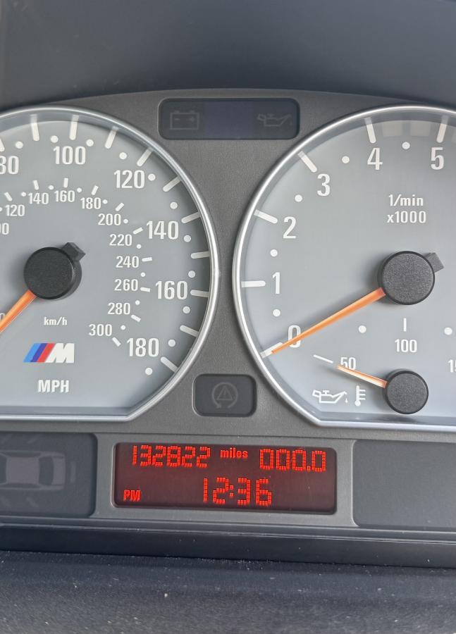

    Howdy folks,
    This morning I finally decided to fix the clock functionality in the binnacle so that I could set and display the time (it stopped working around five years ago or so after the tabs breaking).
    Took the binnacle out, opened it up, removed the half broken tabs, filed the surface down, inserted the 3D printed adjuster hack, put it back together, reinserted the binnacle into the car and set the time.
    The needle works properly now - the time can be set (going both forwards and backwards) and it can be interchanged between AM/PM and 24-hour.

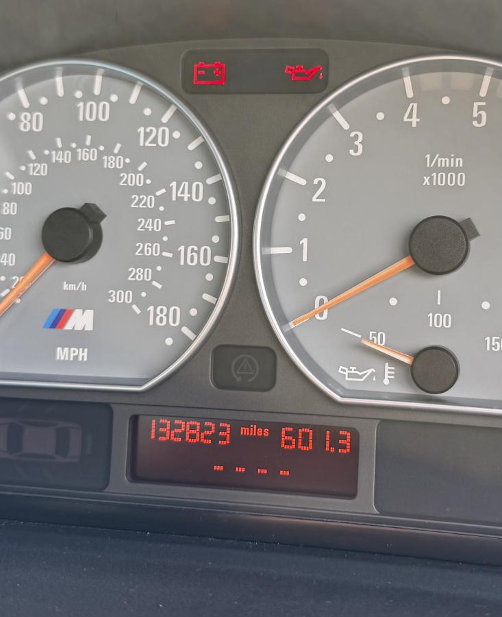

    However, after doing this the mileage changed from 132,823 to 132,822. Not a big deal but any ideas as to why this may have occurred? I.e. why the mileage decided to clock itself back one mile?

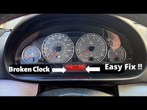

    I followed the steps in this video and noticed that the same thing occurred on the demonstrator’s binnacle.

      My guess is that it's to do with the conversion between km and miles. AFAIK behind the scenes the cluster stores mileage in whole km, and then converts to miles to display to the user if that's the UoM that are configured. The mileage itself (what is stored in EEPROM) is stored in integer units. The finer-grained "how-far-through-the-current-km-are-we?" measurement is in volatile memory. So prior to the procedure you've got:
      (whole_kilometers + current_partial_kilometer) * 0.621371 = odometer_in_miles
      After the procedure you have:
      (whole_kilometers + 0) * 0.621371 = odometer_in_miles
          Sounds plausible, thanks for sharing.
          Although may I ask how you know this?
            I've had KM / euro clusters do the -1 on power off as well.
            I think it's just that your "current_partial_kilometer" is rounded up and stored in volatile memory or something.
              Yes the mileage in kilometers is stored in whole kilometers. Theres a special section EEPROM that can increment and there are sixteen locations so it only writes each location every 16 kilometers.
              I don't know for sure about the part kilometrebut I suspect it is as noted above and only saved with battery power. So it rounds down with a power fail. You wouldn't ever see the issue on a km car.
