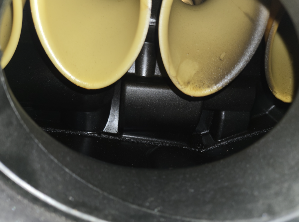

                  So, a small update: I popped the air intake elbow off and sprayed a quick spritz of starter fluid into the airbox. The car started for a moment before dying, which confirms it's a fuel issue (I also unplugged fuse 54 ahead of time to be sure to isolate the test).
                  Before I sprayed starter fluid in, I had a peek into the airbox, and think it looks like there's a bit of a residue/ gunk in there. Any chance this would indicate that the previous owner was using starter fluid gratuitously to keep it running?

                    Thats a film of engine oil, normal.
                      Agree with cubie.
                        Beautiful, thank you both!
