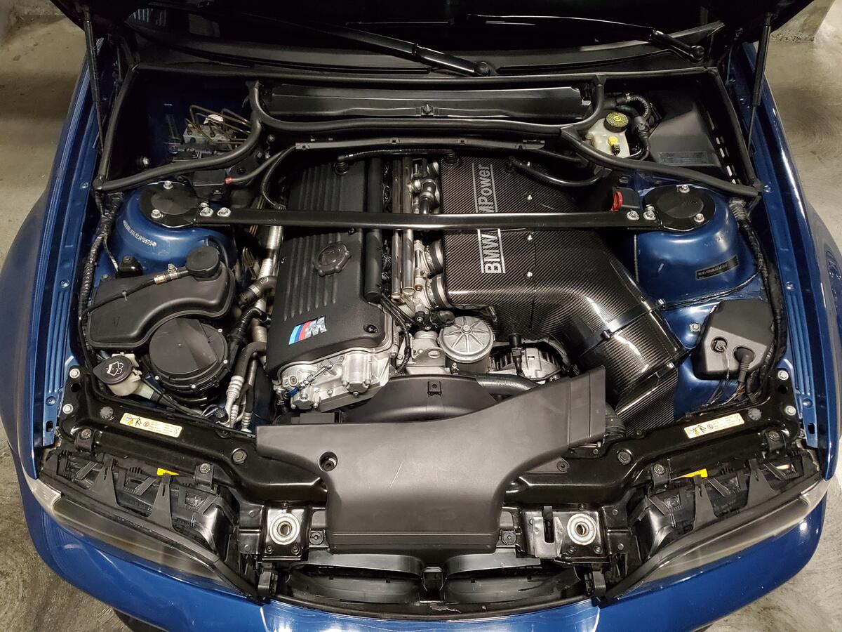

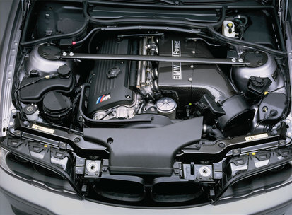

      Is there an easy way to tell if you have MK20 or MK60?
      I have a pre-facelift 03.
        #33
        MK20 will be in the passenger side drug bin. If there's nothing there then you have an MK60. Top left corner on the following pictures.
        MK60
        MK20
            MK60
            MK20
            Thanks man. I have nothing in the drug bin lol
