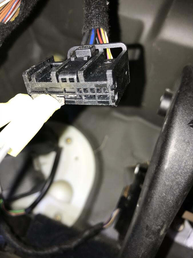

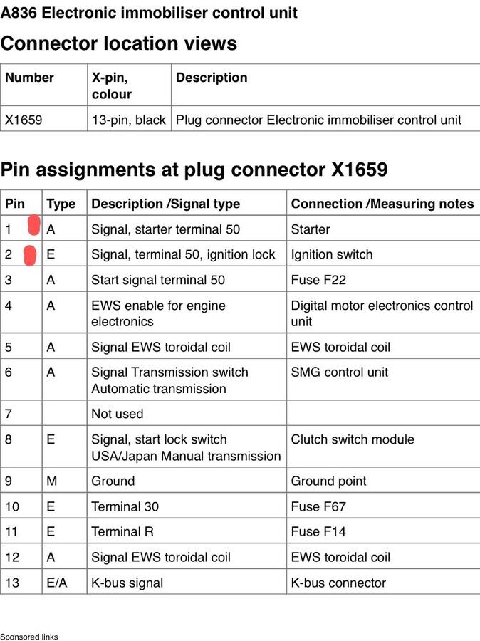

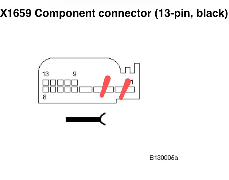

    4. Proceed to the EWS Connector; jumper pins 1 and 2 (see photos)
    5. Turn key, cross fingers!
