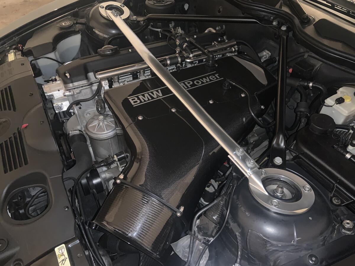

                      I have the short CSL dipstick in my Z4M, the Z4M has more room in the engine bay, and I can still use it at will to check oil, the biggest caveat is that it can let a drop or two fall on the way out. There is actually a lot of room to reach and pull it out.
                      the photo below is not at the ideal angle but you can barely see it.
