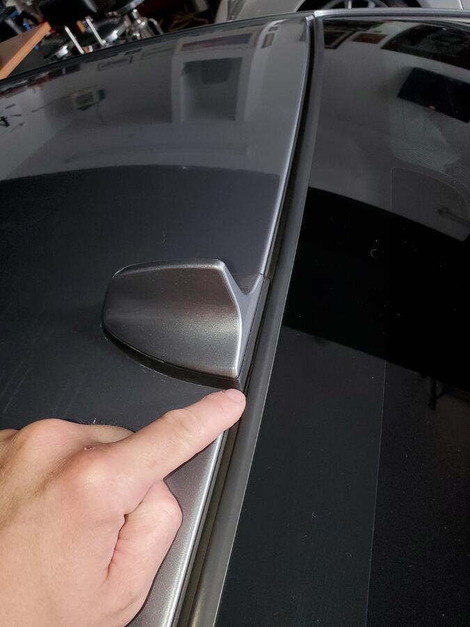

                            The wire just pulls out.
                              So the wires exits the the shark fin right at the top of the rear window or through a hole in the roof? I assume you guys aren't removing these just to uncover a hole in roof. I would be interested in removing this if its easy and no functionally is lost, which it doesn't sound like is the case.
                              So where my finger is is where the wire enters, or is it in the roof itself?
