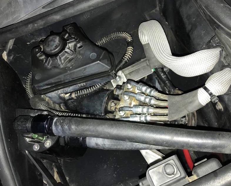

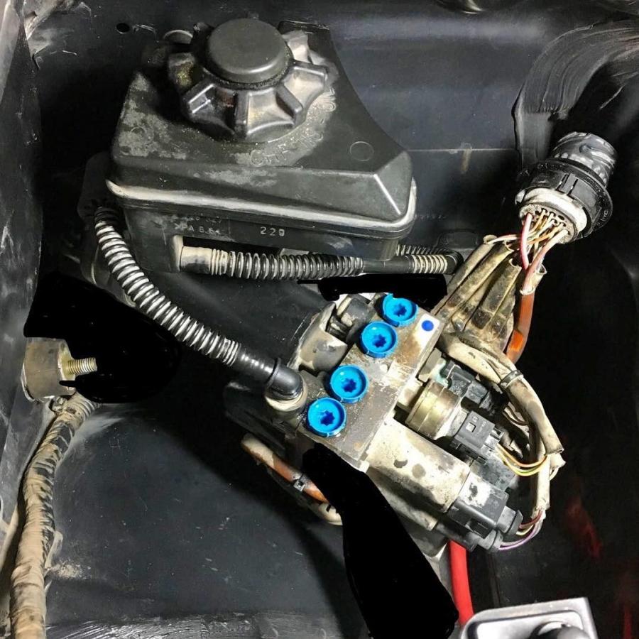

ID:	172073 Click image for larger version
              There is some successfully design where they fit the SMG pump horizontally in the drug pin,Dont know if they are available for sale or at least we could find the design for it.

                That is from my car Ahmed. Mine was a prototype and I will not reveal the design as the creator has asked me not to. Other people like Burkhart sell the bracket.
