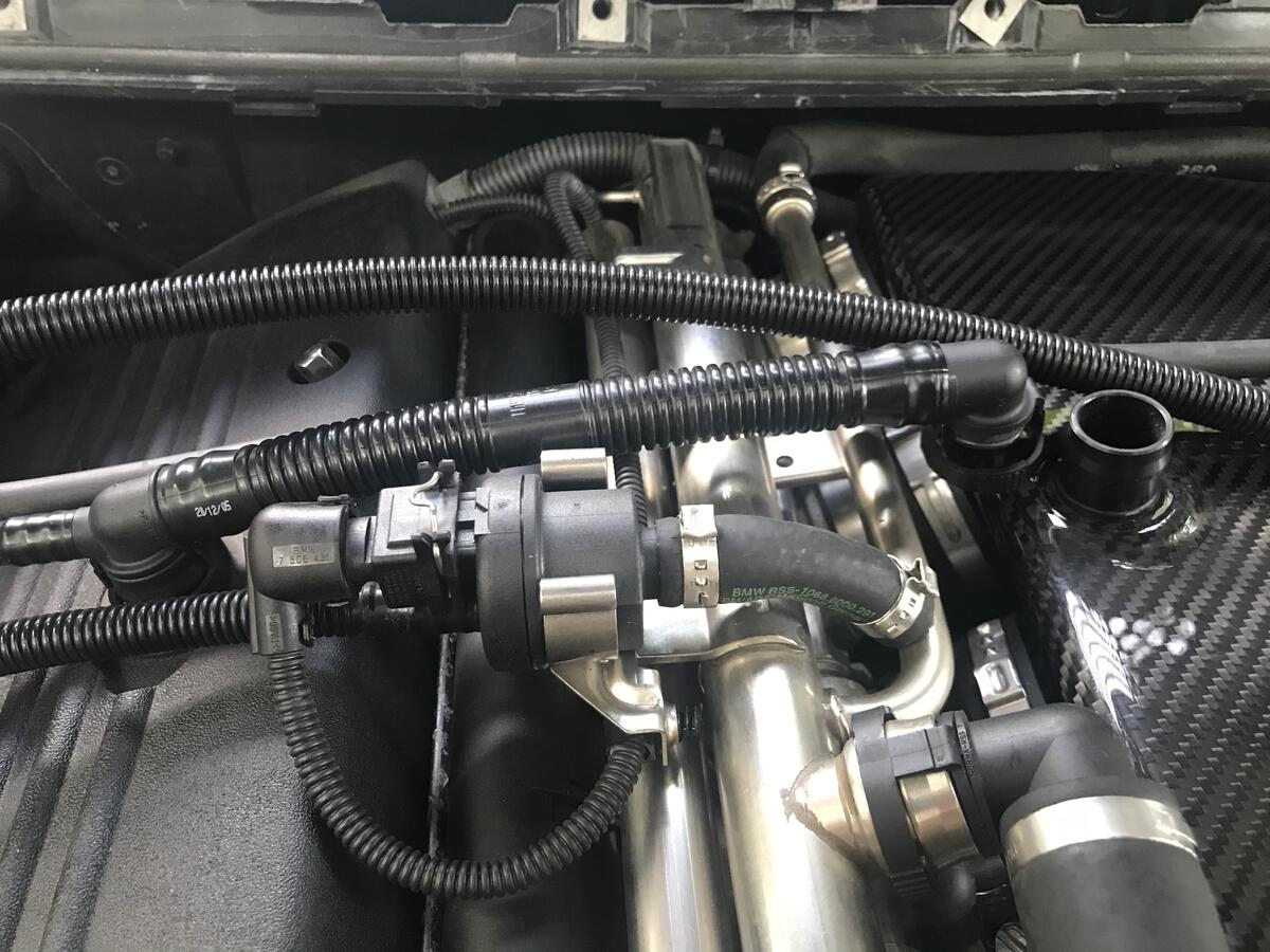

ID:	40215Installing airbox today, this line comes up short, hate to ask a dumb question but what’s the fix here? New line, an extension to existing line, etc? Thanks!
    The CSL version of the breather is longer so you could buy that or you can simply extend the tubing you have by either slowy heating it or cutting/splicing with some other tubing to lengthen it. I would lengthen yours, I went the super pricy route and did the CSL breather an bought a pre-PCV valve air rail, mainly for looks.
      Easiest and cheapest way is to buy some vacuum line that fits and extend the hose. You could also buy the CSL hose (11157833649), but since you've got the solenoid, you'll have to remove it and either fit an early model idle air rail or plug the hole that is left after removal.
        Ok, sounds good, thanks for the quick responses!
          Get a Catch Can!
            I used a section of heater hose to lengthen mine.
