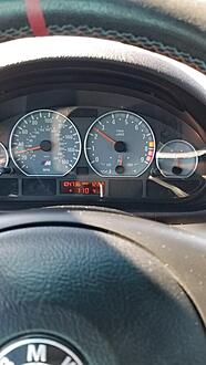

      Not really on topic but not super off topic...a lot of guys simply remove the mech fan and don't add any electric fans (aux stays in place though) and run it as daily or even on track (although you do get a lot of airflow at speed and don't need the fan till you get to paddock). If you are not in stop and go in super hot/humid climate you might consider that. I don't think Michigan sees summers with ambient over like 80(?). Just throwing it out there.
      Here is my car in CA desert summer at 110 ambient and temp just started creeping up after crawling in traffic on highway on a slight uphill before we started moving again. That is with a fresh OE cooling system and no mech fan. AC was on because we were on a roadtrip with wife and 9m old baby (so we also had a tonne of stuff in the trunk).
      Click image for larger version  Name:	Resized_20190809_154331.jpeg Views:	0 Size:	49.4 KB ID:	4113
