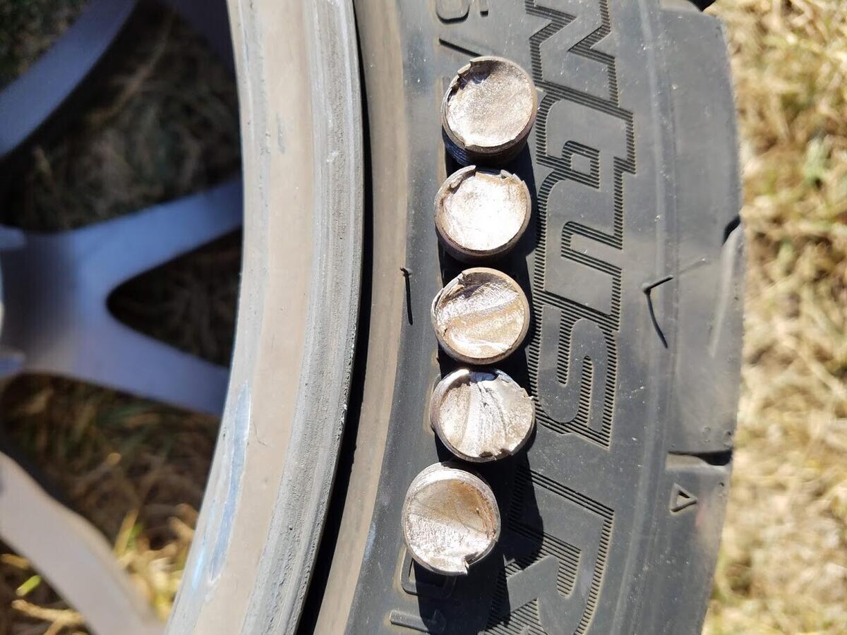

                              FWIW - these are Bimmerworld studs that failed on the rear of an M4 last year at Summit Point:
                              Click image for larger version  Name:	G6KWti.jpg Views:	0 Size:	130.9 KB ID:	41443
                              If you look closely you will see corrosion crept in on most of the studs through apparent hairline cracks (thats rust - not dirt). The belief is that those cracks were caused by using an impact wrench for tire and brake work - torquing repeatedly to unknown values. (I don't use an impact wrench on my stud nuts without a torque stick).
