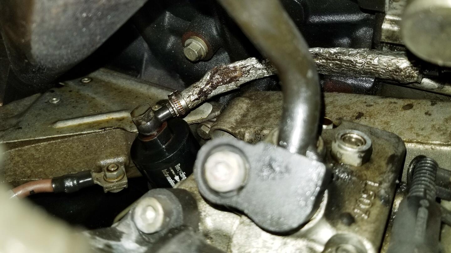

                Took a quick look, maybe a candidate or it's coming from above.

                  That could possibly do it - - mine had a small fracture underneath the heat shielding and it sprayed oil all over the timing chain cover area and headers. Judging by the size of that cut in the line, I'm sure you're losing oil at the rate you're describing.

                          And we have a winner. Pin hole in the vanos oil line right at the mounting bracket which was also broken. You couldn't see it when I took it off but bending the line back and forth a bit exposed it.

                              Wait that picture looks like the oil return line not the VANOS line. Unless there is a VANOS line that has a braided end that I am not aware of.
