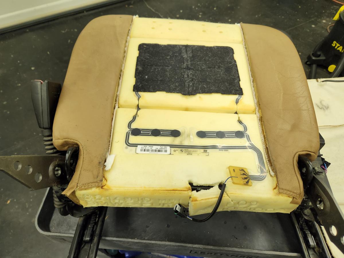

  • heinzboehmer
    replied
    Ok, so I just need one of those occupancy sensor emulators OR code it?
    Yeah, just code it out with ncs
    Leave a comment:
  • Tbonem3
    replied
    Correct
    Get the best deals for E46 Seat Occupancy Sensor Bypass at eBay.com. We have a great online selection at the lowest prices with Fast & Free shipping on many items!
    Leave a comment:
  • Cubieman
    replied
    Leave a comment:
  • repoman89
    replied
    and the occupancy sensor is failure prone
    Another one of the reasons I coded mine off. I would rather have both airbags go off in an accident rather than trust an old, potentially improperly installed sensor in an aftermarket seat to protect my passenger.

  • Obioban
    replied
    What makes you say that?
    As I understand my only other option is an aftermarket plug that would make the passenger airbag deploy with or without a passenger in the event of an impact.
    You can code it off, to accomplish that as well.
    But, yes-- the purpose of the occupancy sensor is to lower insurance rates. It does that by not making passenger side airbags go off if no passenger is in the passenger seat in a crash.
    ... that doesn't seem like overly useful functionality to me after the initial purchase of the car, and the occupancy sensor is failure prone-- so I was happy to be free of it. A future airbag light I won't have. If I end up in a crash where the passenger airbags go off, insurance will still cover replacing them-- they don't know/care if you don't have the sensor.
    Leave a comment:
  • Cubieman
    replied
    You could use it. It’s just not very useful.
    Leave a comment:
  • Obioban
    replied

    Is there any reason I couldn't use a factory occupancy sensor mat beyond it not fitting in the cushion?
    I would like to use one if possible instead of bypassing it.
