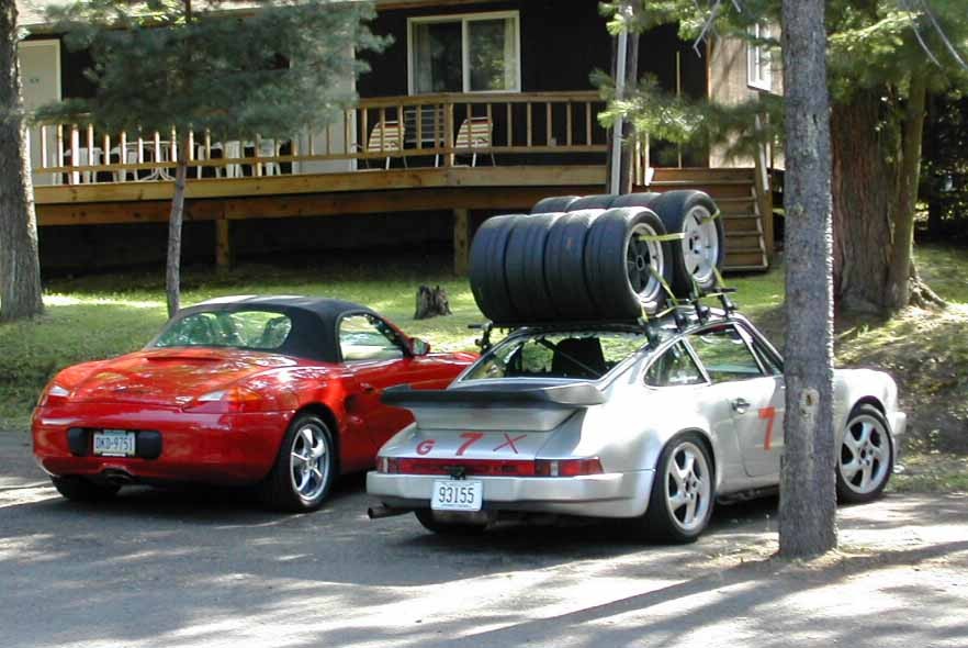

  • zivagolee
    replied
    You need something like this:
    I've done this with a basket before and I didn't like driving a long distance to the track with all that weight up there.

  • mrgizmo04
    replied
    Ha, that was considered, but putting up 4x 40 lbs wheels at the end of the track day, and then when I get back to my garage tired, remembering that they are there before I drive in...plus one of my mounting holes for the roof bar is stripped, so I didn't want to deal with it.
    Leave a comment:
