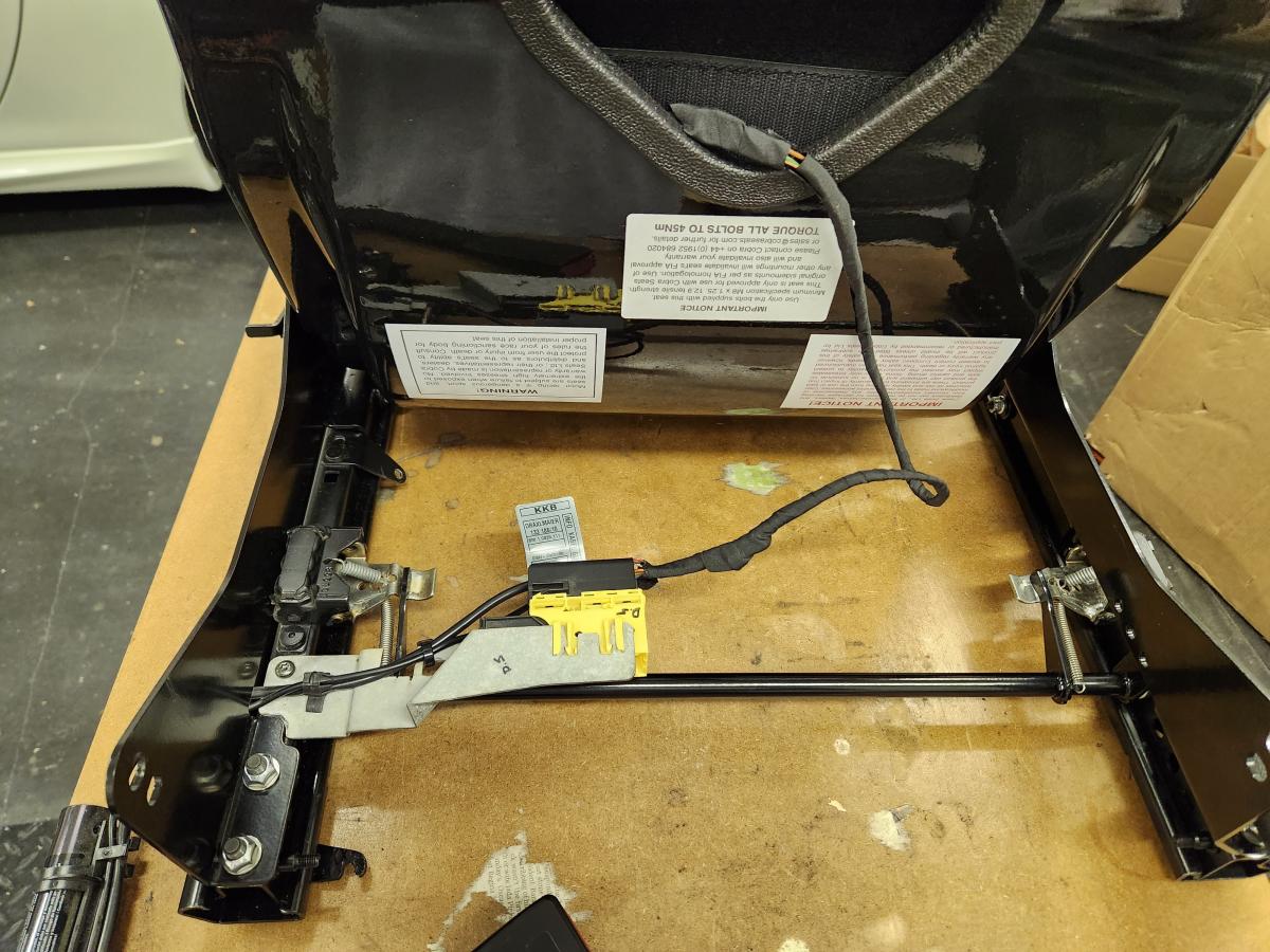

    Just switched my driver side seat over to manual rails today. Seems nice, just a little “sticky” and not quite as easy to get it to slide as typical OEM seats. Is this typical? If not any suggestions for getting it smooth?
    Waiting on the passenger side release handle to do the other side since ECS decided to send me a used/repackaged one without the springs. Replacement on the way.
    The non-motorized slider piece is noticeably lighter … has to be a couple pounds per side
    My seats slide rather easily, are not notchy and my manual seat rails are most definitely not parallel, I had to fight to get them bolted down as they were way off due to the BK mounts.
    Before installation I used a ton of brake cleaner/random tools to get as much of the old grease/debris from the tracks as possible and then used a 10ml syringe with an 18 or 20gauge needle to apply sunroof grease where needed and ran them back and forth numerous times.

    Loosen all the bolts, bolt the seat into the car and down, slide the seat back and forth, and then doing final tightening in car with the sliders fully bolted to the chassis. took mine from sticky to stock like.

    No . The BK mounts seem to push them out of position a bit, so they're no longer parallel and become sticky. See my post above: https://nam3forum.com/forums/forum/m...620#post218620
    No good solution . The BK mounts seem to push the rails out of position a bit, so they're no longer parallel and become sticky. See my post above: https://nam3forum.com/forums/forum/m...620#post218620

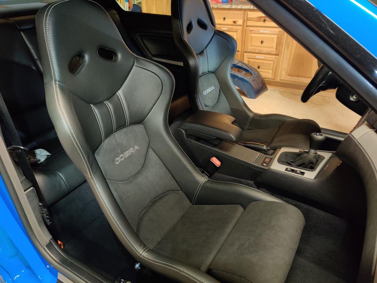

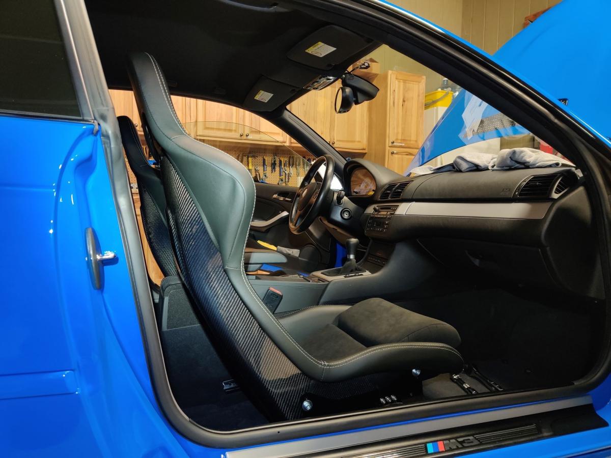

    The project to setup and install Cobra Nogaros with BK mounts on OE power sliders urned out fairly well. There were some surprises during install, especially learning the seat is not precisely centered on the steering wheel. I've already grown accostomed to it. I think I will start up a new thread with only information on the install. This one was so long to review I lost track of the details.
