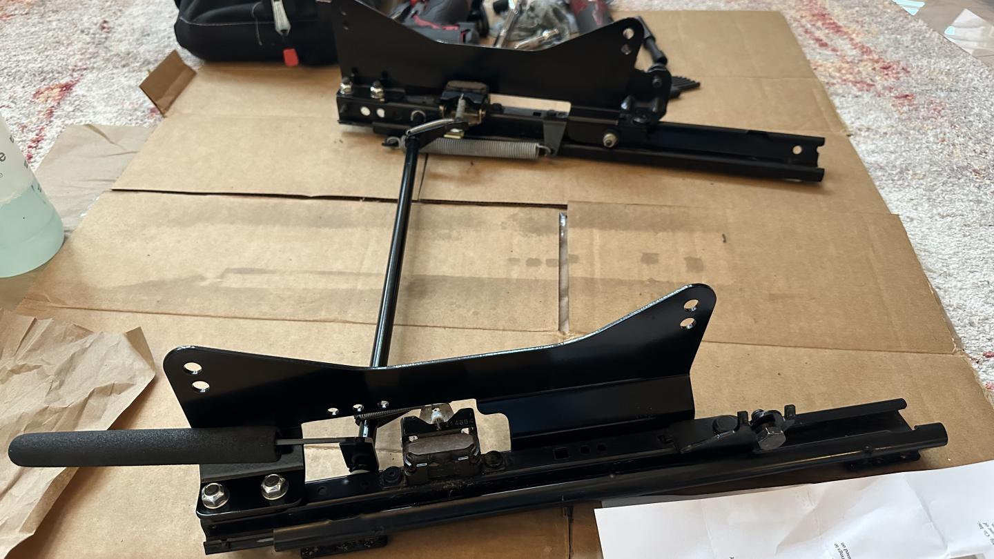

    replied
    Figured out one major problem that was resulting in a good amount of the “stickiness” — the sub strap bar rubs pretty heavily on the carpet where the chassis bumps out toward the front third of seat travel. It feels a good bit better now after removing the bar and reinstalling the seat with loose fasteners as suggested.
    I think I’ll go for a QFP setup for this car instead of all the BK harness mounting stuff — removed the rear mounts today as well and installed a fresh rear deck.
    Has your carpet ever been out? I wonder if it’s not seated fully— my BK sub strap has no friction with the carpet.
    Leave a comment:

  • repoman89
    replied
    Leave a comment:

  • Obioban
    replied
    Any particular grease you used on the rails like Cubieman? Do you tighten the outside seat bolts last after torqueing down the chassis bolts?
    The sliders I sourced looked brand new, so I didn’t add any grease.
    I’d go in this order:
    tighten side mounts to seat
    tighten sliders to floor
    sit in seat. Slide back and forth 10-20 times, full range of travel
    tighten side mounts to sliders.
    Leave a comment:
  • repoman89
    replied
    Loosen all the bolts, bolt the seat into the car and down, slide the seat back and forth, and then doing final tightening in car with the sliders fully bolted to the chassis. took mine from sticky to stock like.
