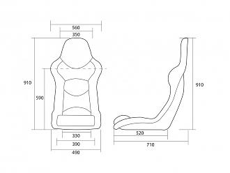

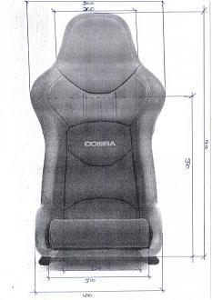

    Noticeable differences? Comfort / fit wise? I see the dimensions but interested in how that translates.

    I had the SPG XL in the M3 wagon at the same time as the Nogaros in my M3 coupe for a while.
